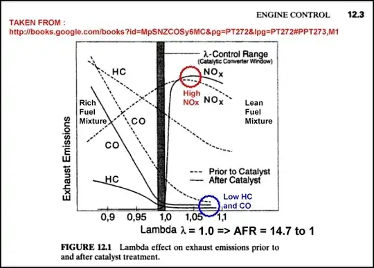

The catch is that cats work well in a narrow AFR window, as this image shows:
NOx, CO, HC vs AFR
  • Run too lean, and the cat will have a hard time scrubbing NOx out of the exhaust gases
  • Run too rich, and your tailpipe will have a lot more HC, CO content
