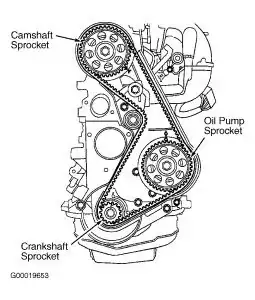

I have an '89 ford ranger that loses power and stutters intermittently around 2000 rpm.
I thought this could be a timing issue. The Camshaft Sprocket and Crank pulley are lined up nicely but the oil pump sprocket is way off.
What symptoms will this cause and could this be related to the issues I'm seeing?

The oil pump pulley doesn't need to be 'timed' so that should not be a concern.
Timing
If you are seeing your cam and crank timed properly together then this is more than likely not your issue.
