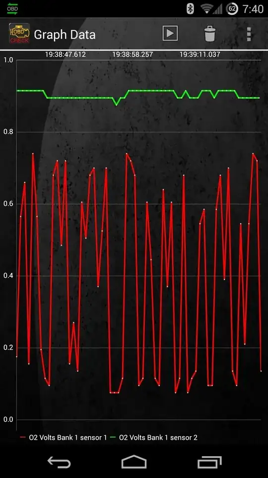

First I let the engine idle for 15 minutes to reach operating temperature. This is the graph of the O2 sensors at idle:
Graph of O2 sensor voltage at idle
From my research I can say that the upstream O2 sensor (red) look okay. It is fluctuating between lean and rich conditions. The downstream sensor (green) is stuck at around 0.9V. I know that the sensor is supposed to be a flat line around 0.5V so this is a problem. It is not clear to me whether this is due to a failed catalyst of a failed sensor.

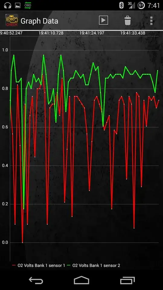

Here is a graph of normal driving:
Graph of O2 sensor voltage under normal driving

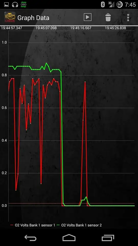

Here is a graph of hard acceleration:
Graph of O2 sensor voltage under hard acceleration

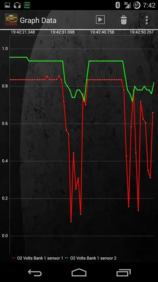

Finally, here is a graph of coasting down a hill. You can see where the computer shuts off the fuel injectors.
Graph of O2 sensor voltage while coasting
These graphs make me think that the downstream O2 sensor (green) is not faulty. Especially the graph from coasting. When the computer shuts off the fuel injectors, the intake becomes extremely lean and both sensors respond immediately. If the downstream sensor was faulty, it should stay stuck at a high voltage. Is this interpretation correct? Can I conclude that I need to replace the catalyst?

Excellent graphs. The after catalyst sensor shows normal mixture readings. The PCM can and will operate the system lean or rich depending on operating conditions. The voltage will rarely be held at any intermediate voltage, such as 0.5 volt. This is an urban legend not based on engineering fact. The rear sensor voltage should remain steady at any steady rpm. It can be rich or lean but should be a flat line. The graphs here indicate rapid mixture change variation which strongly suggests catalyst failure.
Several other test need to be completed to make sure that problems in other areas are not present. A more detailed process of catalyst testing follows.
1) Verify proper fuel control. This is best done by calculating Lambda from tailpipe gas analyzer readings. Since this is not commonly available most will substitute fuel trim, make sure that the trims are less than 10% when long term is added to the average of short term.
2) Verify that there are no exhaust system leaks anywhere near the mixture (oxygen) sensors or the catalyst. Leaks will cause false readings.
3)Verify that both sensors are in good condition. That they will move quickly from rich to lean when the mixture is changed. Usually this is done with a snap throttle. They should both go below 0.1 volts and above 0.9 volts.
4) Monitor the pre and post catalyst sensors at 2500 rpm with the engine and catalyst fully warmed and held at steady rpm. The rear sensor should stay smooth. It can be at any voltage and can change voltage but should do so very often, more that 30 seconds.
