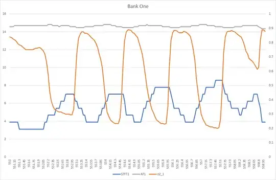

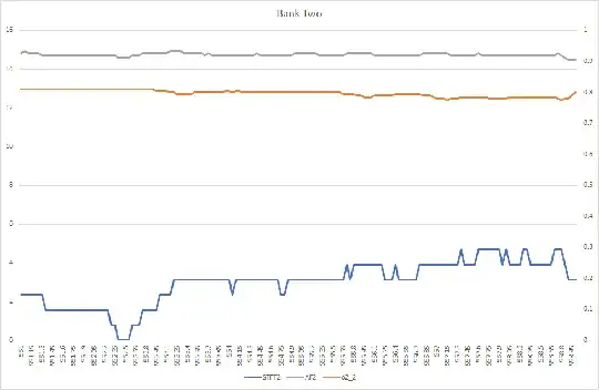

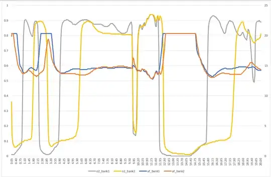

Couple of screenshots attached we can see AFR on bank two is less responsive and also the O2 sensor reaction on bank 2 can be a second or two delayed compared to the bank 1 signal.
I understand the two banks won't be perfectly in sync but more than a second difference seems long with EFI. Could be a normal situation too I guess. Perhaps this is an airflow problem internal to the engine.

The graphs below show data sampled at 20 rows per second;
Screenshot One Screenshot Two

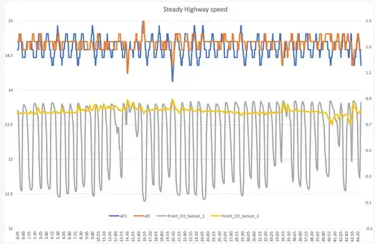

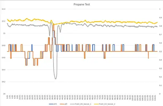

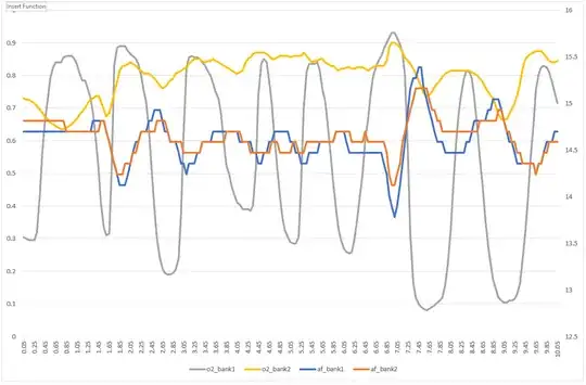

EDIT 2019/06/16 Removed previous propane graph to save space. Adding results of my next propane test from @Zaid's help. The propane bottle may have been running a little low but the results tie in with @Zaid's image regarding a bad cat. Also added a chart showing AF & O2 sensors whilst driving steady and gentle on the highway, bank #1 O2 sensor is all over the place!
Propane test, second attempt Highway cruising
EDIT 2019/06/20 Now logging STFT to find bank 1 is cycling additional STFT at cruise, would this mean an air leak someplace ?
Bank One Bank Two

It looks like there is an issue with Bank 1, not Bank 2.
Given the stellar job you've done with ruling out false readings due to sensors or leaks, it looks like the catalytic converter on Bank 1 is not doing a good job scrubbing out the oxygen, which is why the Bank 1 post-cat O2 is cycling between rich and lean.
