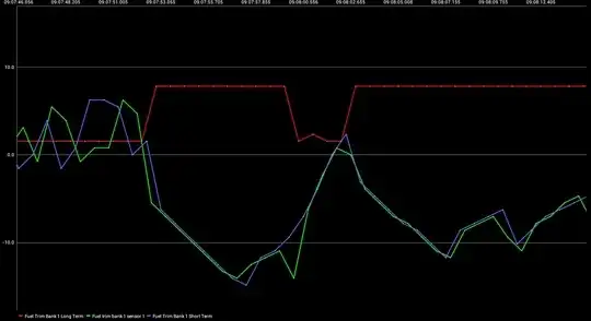

Short and long term fuel trim are erratic this morning during city drives: fuel trim

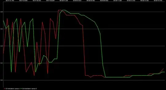

The over-time O2 graphs shows rear sensor (green) tracking front (red): O2 sensors 1 and 2
I will drive it some more and confirm these readings, but if my understanding is correct, rear tracking front usually indicates a bad cat. I still need to get under there and take physical measurements (temperature, resonance), but the heat shield looks undamaged.

If you have rattling on acceleration and the fuel economy is depressed, it is very likely that the catalytic converter core has cracked and it is blocking the exhaust now. You can try to measure its efficiency first by looking if the rear O2 sensor voltage reading after heating is steady (so the catalytic converter is good) or jumping (so it is bad). If it is too much trouble for you to do this test and you can remove the catalytic converter yourself just do it and inspect it to see if it is broken. Mind that some debris may have been flung into the muffler so it may also need to be cleaned or even replaced.
