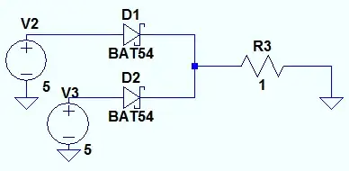

My intention is to design a or-ing power supply option, as either of them will be used at a time. Possible solutions are shown below:
Using oring diodes

  • Using diode is cheap and good option but an ordinary diode gives a drop of 0.7V and a schottky diode will give a drop of 0.16 to 0.20 volts, which is also not acceptable because my processor IMX.28 recommended operating power supply is 5.0V and minimum supply voltage is 4.75. With a 0.2V with schottky diode the 5.0V comes down to 4.80V and the space between recommended and supply fed is very less.

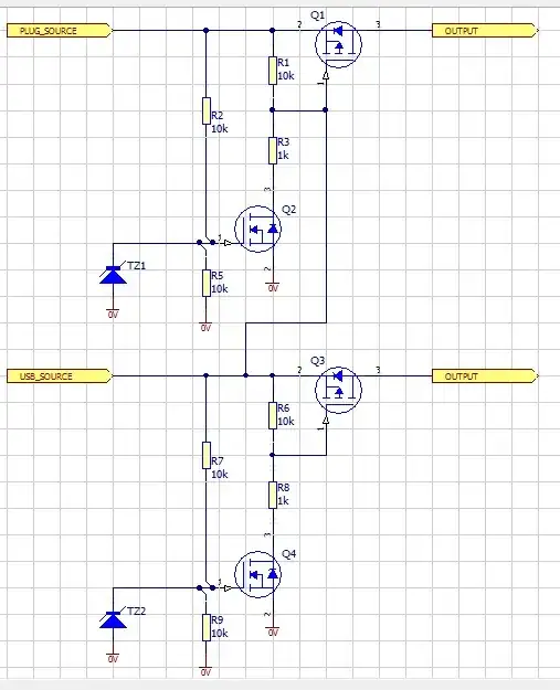

If you want to do it with discretes, you can augment the functionality of your FET arrangement as so:
This will turn on the appropriate FET when the appropriate source is connected.
I imagine that it would be favourable to prioritise the USB source for communications functionality so it takes precedence if both sources are connected by switching the Plug pack source off.

  • Adding an extra MOSFET will increase the price of the solution. I am looking for something cheap!!! – AKR Jan 17 '14 at 09:33
  • You yourself already proposed M1/M2 in one solution. Q2/Q4 are not power FETs but BSS123's or the like. $2 worth of additional parts isn't cheap enough? – Martin Jan 18 '14 at 10:43
    Q1 and Q3 on the Answer 1 seems to be reversed. The body diode will conduct to the source from Output irrespective of the gate signal... –  Jul 14 '14 at 20:37

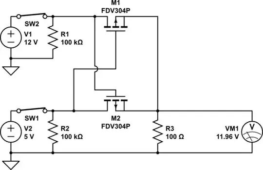

As this question ranks quite high in search results for MOSFET power supply ORing, I'll add analysis of such.
Here is an actually working version of the two MOSFET circuit shown in question. I have flipped the MOSFETs so that the parasitic diode does not leak back to the input, and connected each FETs gate to the opposite voltage input.
schematic
Now, this circuit does work, but it has a shortcoming. If both inputs have the same voltage (less than gate threshold of difference), both MOSFETs will remain off and conduction will be only through the parasitic diode. This will cause more voltage drop.
As such, it is suitable for either separate voltage levels (such as 12V and 5V inputs), or only as protection against rare misconnection (in which case it does not matter that voltage drops if both supplies are connected).
