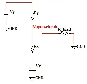

Looking at this from a mathematical standpoint we can explore this concept by looking at the equivalent circuit, specifically the Thevenin equivalent to start.
Below is the circuit you are suggesting to build (including the output impedance of each source): enter image description here
Rearranging things a bit you will agree that the following the same circuit: enter image description here
We we have is a simple potential divider between Vy and Vx. The process of finding the Thevenin equivalent is simple. First, find the open-circuit voltage and then the short-circuit current. The former can be found by disconnecting the load and calculating the voltage. Since we know this is a potential divider circuit we have:
$$V_{open-circuit} = V_x + (V_y - V_x)\frac{R_x}{R_x + R_y}$$
Then we find the short-circuit current. To do this, simply short the output node to ground and determine the drawn current. In this case, the current is simply that which is drawn from each source independently.
$$I_{short-circuit} = I_{V_y} + I_{V_x} = \frac{V_y}{R_y} + \frac{V_x}{R_x}$$

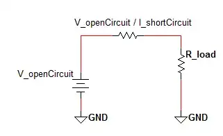

And then, by the Thevenin Theorem, the equivalent circuit has voltage source with magnitude equivalent to the open-circuit voltage and an output impedance equal to the open-circuit voltage over the short-circuit current.
$$V_{open-circuit} = V_{TH} = V_x + (V_y - V_x)\frac{R_x}{R_x + R_y}$$ $$R_{TH} = \frac{V_{open-circuit}}{I_{short-circuit}} = \frac{V_x + (V_y - V_x)\frac{R_x}{R_x + R_y}}{\frac{V_y}{R_y} + \frac{V_x}{R_x}}$$
Therefore, mathematically this is acceptable, but will it yield the results you intend for this combination to provide? It depends on the power supplies being connected.

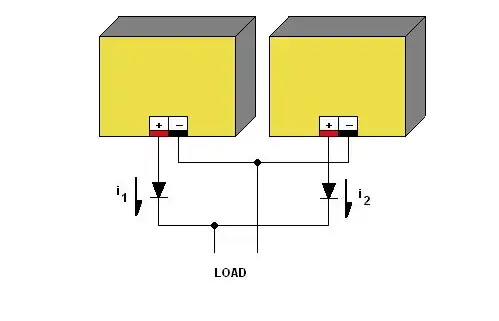

1) You could tie both output together via conventional diodes which solves the problem. However this solution has disadvantages:
  • A voltage drop (typ. 0,7- 1V)
  • Output is actually no longer regulated since the voltage drop varies with the drawn current.
  • The biggest problem however is that due to differences in the dynamic resistance of the PS and wiring and diode resistance the current distribution between both can vary widely (Not 50/50 as one may expect).
2) You could make use of what is called ideal diodes, which are basically MOSFETs with the accompanying circuitry. These components exist in a variety of current ratings have a very low voltage drop and therefore perform much better with respect to the above. Google "Ideal diode". You may want to read this.
3) Best solution is generally a single PS or PS with parallel tracking mode.

  • Using diodes to isolate the power supplies from each other won't help in this situation. And ideal diodes either require external power or the MOSFET acts like a piece of wire once it is turned ON. – Dwayne Reid Feb 14 '15 at 17:06
  • @ Dwayne: I don't see why that would be a problem. So-called ideal diodes are specifically made to "or" power sources and can even be used as a rectifier.
    You are right to say that many PS won't sink current, however the TS can't know this unless he or she tries. If it can sink current the PS probably won't survive the test, if it can't there's still a high chance the feedback loops go "haywire". There's also no guarantee that currents are distributed equally. Diodes solve at least part of this problem. Like I pointed out using diodes is a 'work around' not a 'preferred solution'.
    – Ambiorix Feb 14 '15 at 23:40
  • @Dwayne: I added your remarks to my post. Valuable input. – Ambiorix Feb 15 '15 at 00:01
