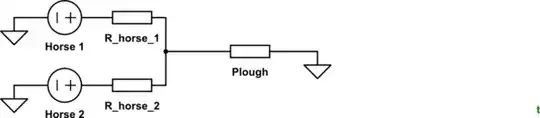

Figure 2. Equivalent circuit of Figure 1. Each horse's internal resistance tends to balance the load sharing.
If your power supplies are tightly regulated but to different output voltages then you may have problems as the one with the higher output voltage setpoint will try to power the load and may backfeed into the second supply. Unfortunately there isn't enough information in your question to address this.

  • Your horse analogy falls apart if you disconnect the plow. To make the analogy work, one horse would need to push the other horse backward. This is the dangerous condition when putting power supplies in parallel...that current from one source will attempt to flow into the other source. This can definitely be dangerous if one is a fully charged 10000mAh LiPo and the other is a 1000mAh discharged LiPo. – Elliot Alderson Jun 29 '19 at 14:43
  • Agreed. I think I covered that in the last paragraph but your comment makes it clear. – Transistor Jun 29 '19 at 15:04
