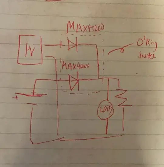

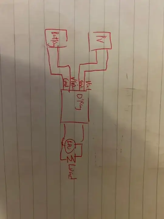

updated photo for O'ring circuitenter image description here enter image description here

To switch between battery and PV array based on availability, you can use an active OR'ing controller. TI, for example, has a wide variety of those and some designs using discrete components have been discussed on this forum as well.
This will allow you to have a battery charging stage and a PV stage. When there will be sufficient power going from the PV panel, your load will draw it from there and not the battery; when there will be no PV power the load will draw power from the battery.

  • Thank you so much for your reply! It gave me some insight! I have looked into the links you provided and understand that this controller can switch between voltage sources accordingly. But I am a bit confused about how the PV charging battery function is established in this case. I assumed the connection to the O'ring controller is as shown in the updated photo. Then how should I connect the whole system with TP4056 to perform the charge controller function. Thanks a lot! @Mu3 – BennyJohn Apr 23 '21 at 20:35

I am currently trying to establish a photovoltaic (PV) system that can charge a 3.7V 100mAh lipo battery and deliver power to a load (1.4V, 0.9mA)... for example, 6V PV panel to a charging module like TP4056, and then connect the load and TP4056 with an LDO regulator to regulate the output voltage to 1.4V.
With a 6 V panel and 1.4 V load there is plenty of voltage 'headroom', so you can simply use diodes to feed the regulator from the highest voltage source.
A '6V' solar panel typically puts out ~7.2 V max, so it should be safe to power the TP4056 directly from it. The Lipo battery should not be discharged below 3.0 V, which means the LDO will get at least 2.4 V from it when connected via a suitable silicon diode, providing 1 V or more of headroom. The solar panel (when illuminated) should deliver at least 5.4 V through a diode to the LDO.
Alternatively you could just connect the solar panel to the TP4056 and the LDO to the battery. The TP4056 is designed to stop charging when battery current falls below 10% of the set charge current. At 50 mA (C/2 for a 100 mAh battery), it will stop charging when current goes below 5 mA. If the LDO draws much less than this it will not prevent the TP4056 from working properly. If your load only draws 0.9 mA and the LDO's quiescent is low then it should work fine.

  • Thank you so much for the reply! May I know how the 2.4V for LDO is calculated 1.4V load+ 1V headroom?), so one 3V diode between Battery, TP4056 to prevent deep discharge then where should another diode be placed to choose the highest voltage source? And will the diode prevent the battery from charging? For the second method, is the LDO connected between battery and Tp4056? I originally thought that the LDO is connected between the load and TP4056 instead. Thank so much! – BennyJohn Apr 24 '21 at 21:11
