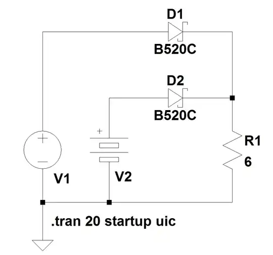

Following is a schematic, and an LTspice circuit list you can use to run a simulation to see how it works.
Basically, if V2 is enough more positive than V1 and the diodes are identical, then D1 will be reverse-biased and V2 will supply all of the current into the load, R1.
Then, when V2 disharges and V2 becomes enough less positive than V1, D2 will become reverse-biased and D1 will supply all the current into R1.
No matter what voltage V2 is, however, if the mains fail and V1 goes to zero volts, V2 will reverse bias D1 and will supply all of the current into R1.
There's a small penalty to be paid, and that's the voltage drop across the diodes, which amounts to about 0.55 volt with 5 amperes through either diode at an ambient temp of 25C. For more info on the diode, the data sheet is here

You can do this, and EM Fields answer is correct as far as it goes.
But be aware that whichever source has the higher voltage will supply most of the current. This means that the battery cannot be charged to a higher voltage than the adapter. This will prevent giving it a full charge. This site indicates that the minimum voltage for charging should be more than 12 volts, although something near 12 will probably work to give a partial charge at a very slow rate. Even if you use an externally charged battery, a lead-acid maintained at 12 volts will not have anywhere near full charge. Here, for instance is a chart which suggests that if your battery is only allowed 12 volts it will only have about 50% charge.
That's not to say you can't do it and get something that sort of works (and may even be adequate to your needs), it's just that you'll need to do some experimenting and may be disappointed with the results.
Diode steering is much better used when the primary voltage is somewhat higher than the backup voltage. If possible, something like a 15 volt supply and a 12 volt battery would be a better match.
