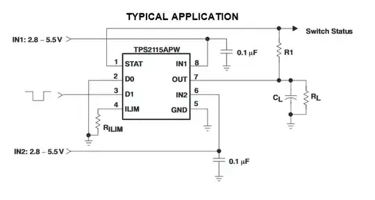

This was one a simple option which needs only two additional component, but you can use specific IC on supply switching purpose.
Example: TPS2115A
Typical application: enter image description here
This solution need more component, thus more board-space, more expensive but here you do not lose voltage and it is more sophisticated.
There could be other ICs it was just an example as I said.
