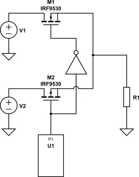

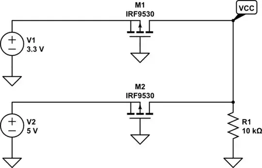

I have several power sources (up to 4) going into a circuit and I would like to be able to power it with "automatic" selection. I have looked up power OR-ing and diodes are dissipating more power than I can spare so it was suggested to use P MOSFETS because they have a lower Z.
The problem is that I can't seem to make them work even in simulation and I see a significant voltage drop. Can anyone spot the error?

schematic
The main difference between my question and the one suggested as having a possible answer is that I have 4 power inputs, not 2.

You have mixed up source and drain. It has to be connected this way:
schematic
Rule: FET body diode is in the direction the arrow shows.

  • Also note that circuit may not work with 3.3V, as PMOS FETs need a bit more voltage to be enhanced. – Janka Oct 29 '16 at 11:29
  • Ok, therefore deleted my comments. You're taking the easy path, however. What's in U1, now? Honestly, that isn't this straigthfowrard and highly depends on OP's constraints (that are missing from his post). – dim Oct 29 '16 at 11:59
    Staying on the easy path, I just searched for "low voltage ideal diode" and found this controller chip: http://cds.linear.com/docs/en/datasheet/4353f.pdf. $7 a single piece at digikey. May suit the OP. – Janka Oct 29 '16 at 12:10
  • You appear to have have mixed up source and drain since the IRF9530 is a P channel enhancement mode MOSFET, which means that its drain must be more negative than its source for it to work properly. – EM Fields Oct 29 '16 at 12:32
  • @EM Fields: No, it's okay in this direction. The body diode has to be in desired current flow direction, contrary to the normal way to use a MOSFET. If you use an NMOS FET, you have to switch drain and source to have the body diode again in the direction of desired current flow. – Janka Oct 29 '16 at 12:46
  • @Janka: Sorry, but no. HERE IS YOUR CIRCUIT with the parasitic diodes shown. Notice that the MOSFETs aren't even used, so the supplies are diode isolated and there's no meaningful active switching going on at all. – EM Fields Oct 29 '16 at 13:18
  • Yes, and that's correct. Because, when you have the parasitic diodes the other way, current can flow in the wrong direction regardless if the MOSFET is on or off. Please see e.g https://www.maximintegrated.com/en/app-notes/index.mvp/id/636 – Janka Oct 29 '16 at 13:24
  • @Janka: Didn't you read my answer? – EM Fields Oct 29 '16 at 16:19

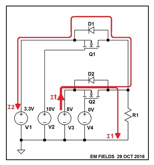

The "error", I* believe, is that you forgot about the MOSFETs's parasitic diode, which won't let you do what you want even if the "inactive" transistors are turned OFF.
For example, below, if Q1 is turned OFF and Q2 is turned ON, D1 will be forward biased and will connect V3 to V1 as well as to R1.
However, if Q1 is turned ON and Q2 is turned OFF, D2 will be reverse biased by V3, so that'll work.
I don't think the scheme will work, in general, since there'll always be one diode forward biased unless the only thing ON is the transistor switching the lowest voltage supply.
By the way, I've posted the LTspice circuit list after the grasphic just in case you want to play with the circuit.
