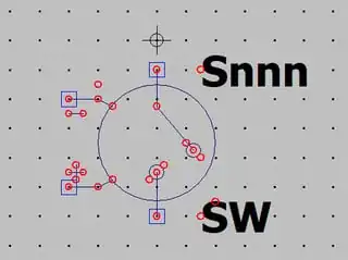

It's very simple to construct your own parts in LTspice. The existing voltage controlled switch is an excellent example. If you just grab the "sw" part and drop it onto a schematic, you can CTRL Right-click the symbol and get a dialog box. In the upper-left corner you should see a button called "Open Symbol." Use it. This will call up a display that looks like the left side below. Use the "copy" feature and select the area you see surrounded by the black rectangle showing on the right side:

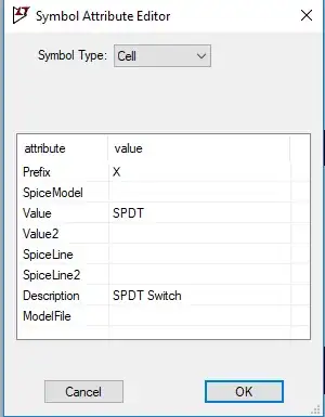

You are very close. Now, use the Edit/Attributes/Edit Attributes menu to get the dialog box showing on the left. Change the \$\text{<Prefix>}\$ attribute from S to X. (You need that because you will make a SUBCKT model. And SUBCKT models must be marked as X, not S.) Also change the \$\text{<Value>}\$ attribute from "SW" to "SPDT". Then hit the OK button. The result should look like what's on the right side, before you hit the OK button.

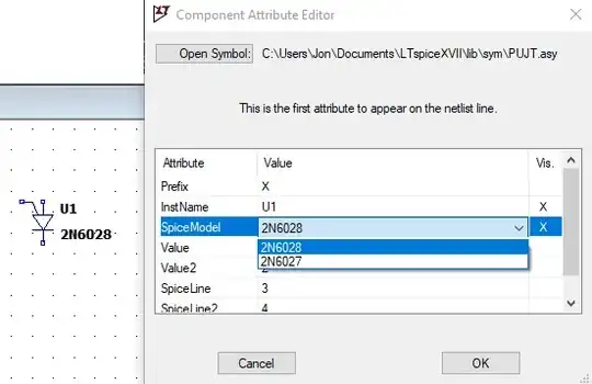

Now here is something important. If you place your default device type (the .SUBCKT you'd like to default to) into the \$\text{<SpiceModel>}\$ attribute and if you specify a \$\text{<ModelFile>}\$ attribute that references a file containing many different models that are appropriate for your .ASY (in my case, three pins) then you can right-click the symbol on your schematic and then double-click the \$\text{<SpiceModel>}\$ attribute and it will automatically present you with a list of .SUBCKT models contained in your \$\text{<ModelFile>}\$ attribute's file. Even if there are dozens of them!
This is really nice.
So, for example, here's a picture after I've right-clicked and then double-clicked my PUJT symbol:
Note that both of my models show up for easy selection.
