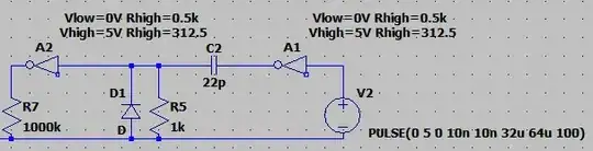

I have an example with just two inverters:
and that second inverter doesn't reach 5 V output when the "load" R7 is 1 kOhm. But in real life I know that if I use a 1k resistor to ground I get fine near 5V potential on the output. So I know that somehow these parameters don't work right in LTspice.

  • There was an LTspice group, with lots and lots of custom files, on Yahoo. That's been moved somewhere. But the files are still there. You should dig around and see if you can find their large library of files. I think they have at least a set for HC types. But they may have TTL or LS TTL there. I never bothered with them, though. You can also just cobble up a .SUBCKT for combinatorial stuff like the NAND, AND, OR, NOR, XOR. Took me just a few minutes to make a NAND, for example. Go here to see how you can make your own symbols. – jonk Aug 25 '20 at 01:48
  • For example, you can just steal the diffschmtbuf from the Digital subsection of LTspice's symbols, edit the darned thing to arrange for an A and B input, a Y output, and access to ground and Vcc. (That's 5 pins total.) Save it. Create a model file with a .SUBCKT and link the two. You can make it generic by creating a model file with lots and lots of .SUBCKT models in it (one for AND, one for NAND, etc.) and then LTspice will drop down a nice menu of choices to use and then it will just work right when you use it. – jonk Aug 25 '20 at 01:55
    Examine this snapshot from an LTspice page. There, you can see the full schematic of a NAND, plus a .SUBCKT of the same NAND, plus a cobbled-up NAND symbol (that looks nothing like the logic symbol for it, but who cares?) that uses the .SUBCKT, plus two cases that demonstrate the output of the NAND, correctly. – jonk Aug 25 '20 at 02:04
