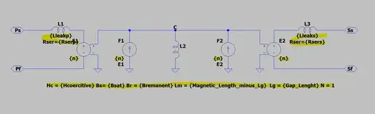

I have created a subcircuit on LTspice. Here it is:
It has a lot parameters that I would like to adjust.

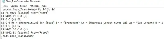

Her is the netlist:

I think you had a similar question before. At any rate, just RCLick on the symbol (or Ctrl+RClick) and simply add n=<value> Lleakp=<value> ..., then optionally double click on the entry in the Vis. column to make it visible and more accessible in the schematic. If you need those values paramterized in the top level schematic, simply add your .param statements then enter n={<param>} Lleakp={<param>} ..., and so on. BTW, this is also described in the help under Schematic Capture > Editing Components.
