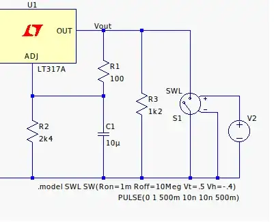

I'm trying to simulate two scenarios in LTspice. One is when things are ok. The second is when a short happens. As you can imagine I'm a beginner with LTspice. At first I was just putting a resistor at the output of my circuit to simulate my load. And when I wanted to simulate the short, I put the resitor at 1 mohm.
But I'd like to "automate" this. A short that happens after the sim has been running for some time.

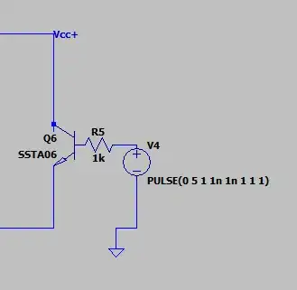

I tried this. But I don't have a perfect zero when shorted.
But I've seen another solution:
When I do this I get the error : Can't find the definition model "SW".
EDIT: Thanks to Winny and his link I was able to correctly set up my short. You can also find more about switches in a post here

    For your switch problem, you need to add a spice directive as outlined here: https://www.analog.com/en/technical-articles/ltspiceiv-voltage-controlled-switches.html# and name your switch to the same as in the spice directive. – winny Apr 29 '21 at 08:06
    @Neeko I was thinking you could just add it or remove it, running each time. Up to you. The other option is the voltage controlled switch you had trouble with. I was just trying to avoid writing up details on that. (I've written about it here, for example.) – jonk Apr 29 '21 at 08:14
  • @winny Thanks for the link. It was detailing at the end how to do a proper short with that switch. – Neeko Apr 29 '21 at 08:31
