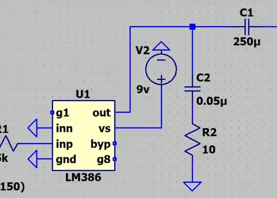

LTspice circuit.
I couldn't find solution for this part of my simulation.

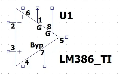

My LM386 files
Here's what I happen to have as the two related files you can use:
LM386.ASY:

The above text can be copied into Notepad or some other text editor and then saved into a file residing in the SYM subdirectory within your LTspice file folders. I used the name "LM386.ASY" as LTspice looks for the .ASY extension there.

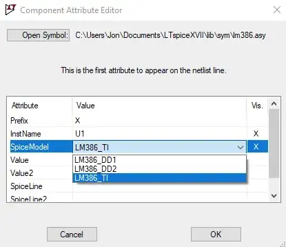

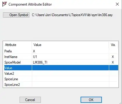

The above text can be copied into Notepad or some other text editor and then saved into a file residing in the SUB subdirectory within your LTspice file folders. Unless you edit the name in the .ASY file I provided above, then you must use the name "LM386.LIB" here. LTspice will look into the .ASY file to find the name of this file. If they don't match up, there will be a problem. If you don't like the name "LM386.LIB" and would prefer "LM386.MOD" then you can do that. But you will have to edit the .ASY file I earlier provided so that it also names the same file.
Once you do this, you can fire of LTspice and create a new schematic and use F2 to select the part from the list. Once it is on the schematic, you can right-click the part (at least, in Windows) and see this:
Here, you can move the mouse over the SpiceModel, underneath the Value column where it says "LM386_TI", left-click that line, right-click in the highlighted Value column and select the little drop-down arrow to see:
And there you can see the three LM386 model choices. Pick any one of them you want.
If you find other models you'd like to add, you can do that by editing them into your LM386.LIB file. LTspice will automatically find them and add them to the list of choices.

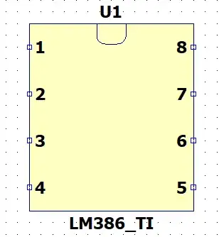

I provided a symbol above. But there are times when you just don't care to go to the trouble of making one. LTspice also provides a number of convenient generic symbols.
For example, if you dig into their lib/sym/Misc folder you will find a DIP8, DIP10, DIP14, DIP16, and DIP20. I could have just selected the DIP8 symbol and edited that, instead, saving it perhaps under the name "LM386_DIP8.ASY".
Here's the result of that editing process that you can use instead of the above symbol:
LM386_DIP8.ASY:
Version 4
SymbolType CELL
LINE Normal -20 -128 -20 -112
LINE Normal 20 -128 20 -112
LINE Normal -8 -100 8 -100
RECTANGLE Normal -112 -128 112 128
ARC Normal -20 -124 4 -100 -20 -112 -8 -100
ARC Normal -4 -124 20 -100 8 -100 20 -112
WINDOW 0 0 -144 Center 2
WINDOW 38 1 145 Center 2
SYMATTR Prefix X
SYMATTR Description LM386 Audio Power Amplifier
SYMATTR SpiceModel LM386_TI
SYMATTR ModelFile LM386.LIB
PIN -112 -96 LEFT 8
PINATTR PinName 1
PINATTR SpiceOrder 1
PIN -112 -32 LEFT 8
PINATTR PinName 2
PINATTR SpiceOrder 2
PIN -112 32 LEFT 8
PINATTR PinName 3
PINATTR SpiceOrder 3
PIN -112 96 LEFT 8
PINATTR PinName 4
PINATTR SpiceOrder 4
PIN 112 96 RIGHT 8
PINATTR PinName 5
PINATTR SpiceOrder 5
PIN 112 32 RIGHT 8
PINATTR PinName 6
PINATTR SpiceOrder 6
PIN 112 -32 RIGHT 8
PINATTR PinName 7
PINATTR SpiceOrder 7
PIN 112 -96 RIGHT 8
PINATTR PinName 8
PINATTR SpiceOrder 8
Same behavior. Just a different-looking symbol.

    @ade When you feel you've waited long enough to see if there may be answers you like better, you can select an answer. The reason to do this *isn't* because you want to please someone else who wrote an answer. In fact, I hope that is never your reason. But doing so does help others avoid wasting their own time, thinking you didn't get what you needed already and where they take a lot of their time because they just want to help you out in a different way. – jonk May 16 '22 at 06:13
The symbol pattern is not the same but looks like an Op Amp. If you keep digging you might find your preference.
