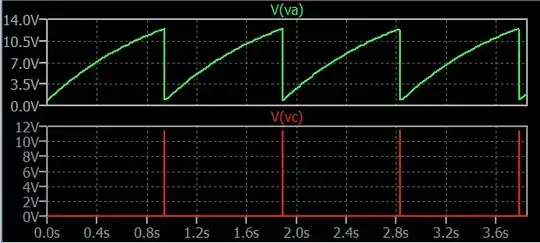

Well, it was probably too short to show, to scale, because the charging period is long while the discharge period is very short. So perhaps they just got an artist to "wing it?" No idea.
Here's what it really looks like:

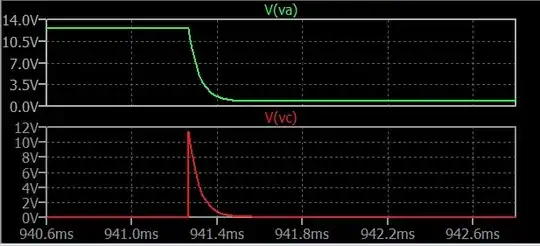

And zoomed in a lot, you can see what the discharge curve actually looks like (in red):
Well, what do you know? It really is a discharge curve! Who would have thought that from reading that book?

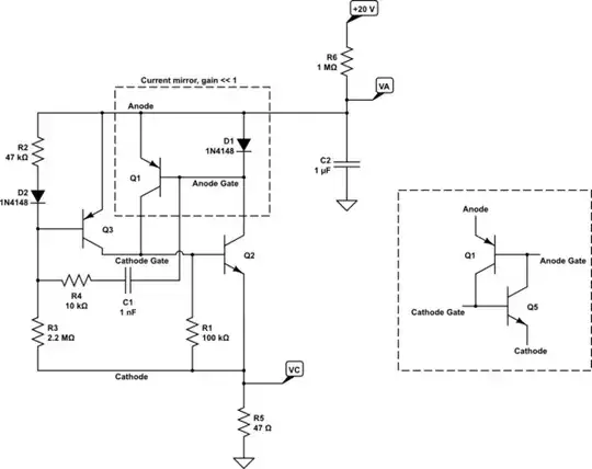

Just use regular BJTs
You can fabricate a kind of fake PUJT without actually having to own one. But the design is... slightly different. Here's the resulting output of the one I'll draw, shortly:
Now here's the schematic. As you can see, it's similar. Nice thing is that it works with "regular" junk box parts and it is modestly temperature-stabilized regarding the threshold voltage.
schematic
Over on the right you can see how the PUJT is often diagrammed out, in books, using two BJTs. It's just that it is kind of tricky to actually drive that beast well, when the BJT parameters are coming from your junkbox (and wired together using copper) instead of from some FAB design lab (and directly sharing junctions.) If interested, take a look here for a short discussion about that generalized BJT version. You'll see something similar to the above there. But... there are some notable differences, too.
It's a heck of a lot easier to just buy some PUJTs. Do it soon. I don't know how long supplies will last! (Is anyone still building them? I have my lifetime supply. Do you? ;)

  • Note that, if I'm not mistaken, that the NPN transistor has a fairly large beta (around 100) while the PNP transistor has a much lower beta (around 5 to 20) – Antonio51 Aug 03 '21 at 07:53
  • @Antonio51 A 2N2222 (NPN) is about 200 and a 2N3906 (PNP) is also about 200. It all depends. But yes as a general rule, NPN has a little more beta than a PNP. The circuit doesn't depend as much upon those details as I suspect you are imagining. – jonk Aug 03 '21 at 08:00
  • A liitle, yes ... It is only the fact that the main current passes through the base of the PNP transistor. There is another point to point out. Note also that one generally makes an approximation relative to the functioning of PUTs or UJTs. The tipping points are not, in fact, the high (Vp, ip) and low (Vv, iv) points of the characteristic curve U = f (i). Depending on the inclination of the "load line", the "up" tipping point is slightly to the right of the Vp point, and the "down" tipping point is slightly to the left of the Vv point. – Antonio51 Aug 03 '21 at 08:09
  • @Antonio51 I think you may be missing the point of $D_1$. It's there to create a current mirror with a gain very, very much less than 1. The beta of $Q_1$ doesn't factor much. The above circuit "just works." Try it sometime. There is positive feedback via $R_4$ and $C_1$ that forces the process, well. It's important and the circuit doesn't work well without it. I'd very much enjoy seeing a post by you on this topic, though. Perhaps it would benefit both me and the OP. – jonk Aug 03 '21 at 08:10
  • In your left picture, ok. I was talking about the picture at the right (only the PNP and NPN transistor). – Antonio51 Aug 03 '21 at 08:14
  • @Antonio51 Ah. That thing doesn't work. Not ever. Not without very, very careful selection of BJT parameters. I've had nothing but trouble trying to make it work with BJTs from the junk box. Pretty much never works. I hope I didn't make you feel it did work! I provided a link to a page where that's explored a little more. But perhaps not well enough. – jonk Aug 03 '21 at 08:14
  • I will try, but I think it does :-) – Antonio51 Aug 03 '21 at 08:16
  • @Antonio51 Hmm. Perhaps you'll have better luck than I have had. Best wishes on that. I've played with it far too many times, though. I do NOT mess with it anymore. That said, I did provide BJT models in the .SUBCKT that *do* work fine. So it is possible. I'm not saying it isn't. Just that I almost never get so lucky. – jonk Aug 03 '21 at 08:17
  • I just try ... It is ok ! I add in an "answer" because of picture ... – Antonio51 Aug 03 '21 at 08:32
  • This model works but adds extra parts (current mirror) not necessary to make work with "junk parts" But I appreciate the need for snubbing the base high impedance as it is sensitive to xx mV of noise. – Tony Stewart EE75 Aug 04 '21 at 10:36

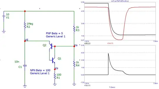

Revised answer:
Why doesn't the PUT go back to forward bias as soon as the capacitor starts discharging.
Because all the time, both Transistors are OFF, except during the pulse. During this time, the NPN has pulled the PNP emitter to reverse cutoff , which should not be greater than Veb=5V for transistors, while the forward voltage for the PNP is ~ 0.7V.
The rise time is controlled just by the Anode pullup, R4, C1. The C1 can be connected to either V+ or 0V. Once Vpnp-e rises 0.6V above the trigger threshold V of divider R1,R2 , the PNP triggers again.
It is not hFE or Ib triggered , but rather voltage triggered. Once PNP conducts some xx uA it pulls up the NPN in a positive feedback clamp which immediately turns off the PNP emitter low.

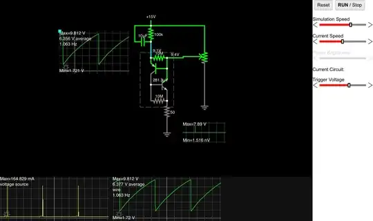

To prove this point, I used a large R Pot with a cap then a big series R to the gate.
With the pot pulled up to highest threshold to create 0.6V=PNPbe, the rise time is the longest slightly more than R4C1=T=1/f. Lowering this trigger level, reduces the sawtooth peak amplitude and reduces the time interval thus increasing the frequency with about a 1:1000 frequency range easily.
A single supply 5V is all you need. R3 limits the current with 47 ohms but I chose 50mOhms to generate a few Amps per pulse with xx uA in between.

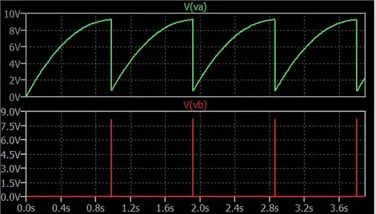

I disagree* that the PNP must be a low Beta or hFE or “dirty”. Neither or both can be low current gain as long as the loop gain > 1 (Barkhausen criteria) and Beta >=2 in both or either.
This is an astable voltage (Vbe) triggered oscillator that spends all of it’s sawtooth ramp time when the transistors are off when hFE goes towards 0. ( They are only triggered by the Vbe ~0.7V of the PNP and then Ic it produces to overcome Early Effect Rce )
Here is my simulation

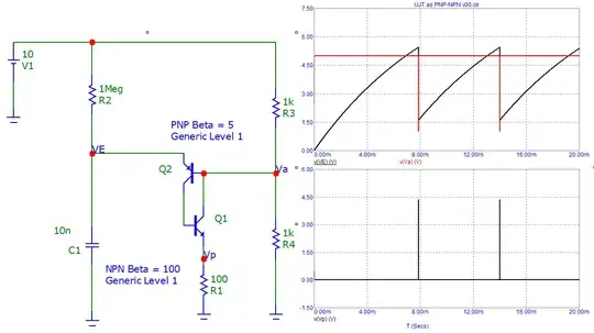

Question 3, just adding simulation of PUT-UJT = 2 transistors PNP-NPN (! see beta). Note that the "internal" behavior of UJT is not the "same".
https://www.electricalengineeringinfo.com/2014/06/unijunction-transistor.html
New EDIT : Here is a old model PUT & SCR BRY39 ... I used in my "youth time" http://images.100y.com.tw/pdf_file/BRY39.pdf
See the parameters of the NPN (hFE=50.. ) and PNP (hFE = 3..15) transistors.
Beta of PNP is low. It is a "bad" transistor (hFE). And it seems also for the NPN transistor. It is only the fact, I think, that the main current must pass through the base of the PNP transistor.

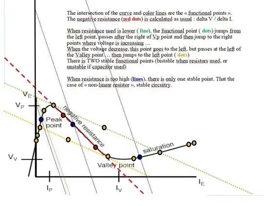

Added enlarged picture at pulses
And another picture for "Load line" ... case of UJT.

  • With a tank load, it becomes a very high power oscillator when self biased, the model is not much different than a gunn diode or an air resonator using the transconductance gain – Tony Stewart EE75 Aug 03 '21 at 12:56
  • I disagree that the PNP hFE has to be low, it is the loop gain that matters > 1 , in fact the oscillator frequency is somewhat independent of max hFE since it is triggered by Vbe only and not Ib, then it all the time the ramp is during Off time . So hFE or Beta can be 10 on either or both to function. – Tony Stewart EE75 Aug 03 '21 at 13:05
  • @Tony Stewart EE75 I remember only that for SCR, in some papers, this transistor was described as a "bad PNP" transistor because the main current must pass through it ... To be verified, then ? Perhaps not in the PUT. But physical descriptions are now difficult to be available ... – Antonio51 Aug 04 '21 at 09:04
  • OK, but as you will see from my simulation, that isn't necessary , except for the negative Early effect must be more than the positive Early Effect so they stay OFF with high impedance gate voltage! So please modify your description of "dirty" – Tony Stewart EE75 Aug 04 '21 at 09:30
  • Also the curve you show is not to scale as Iv/Ip can be several orders of magnitude – Tony Stewart EE75 Aug 04 '21 at 09:38
  • Right. It is only for explaining the principle of the "Load line". The measuring of these curves are not very easy. – Antonio51 Aug 04 '21 at 09:49
