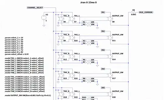

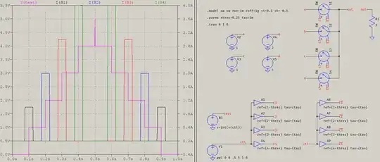

I need to implement what I will describe as a power multiplexer for use in testing other circuits in LTSpice.
The idea is to be able to switch a range of loads and sources into the output of the circuit I am working on. For example, I might want to test with a pure 100K resistive load, pure 1K resistive load, 10uF capacitive load, 1A current source (load or source, depending on how you look at it), inductive load, short to ground, short to V+, etc.
Imagine a bank of physical switches connected to the UUT. You use this bank of switches to see how it reacts to being connected to a range of circuits/loads/sources/sinks.
I also want to keep it simple, in the sense that it should create minimal simulation load.
Finally, rather than control it digitally, I want to control channel selection using a voltage. This allows for using PWL ramps or stairsteps and automating the testing with all available loads and sources.
Here's what I've come-up with. It works. Can it be improved?
LTSpice Power Multiplexer
Only showing a few channels in the image, here's the entire model (includes extra hardware for testing):

TEXT 616 264 Left 3 !.tran 0 23ms 0
TEXT -400 744 Left 2 !.param select_1 = 1V\n.param select_2 = 2V\n.param select_3 = 3V\n.param select_4 = 4V\n.param select_5 = 5V\n.param select_6 = 6V\n.param select_7 = 7V\n.param select_8 = 8V\n.param select_offset = 0.2V\n \n.model TH1_L SW(Vt=select_1-select_offset)\n.model TH2_L SW(Vt=select_2-select_offset)\n.model TH3_L SW(Vt=select_3-select_offset)\n.model TH4_L SW(Vt=select_4-select_offset)\n.model TH5_L SW(Vt=select_5-select_offset)\n.model TH6_L SW(Vt=select_6-select_offset)\n.model TH7_L SW(Vt=select_7-select_offset)\n.model TH8_L SW(Vt=select_8-select_offset)\n \n.model TH1_H SW(Vt=select_1+select_offset)\n.model TH2_H SW(Vt=select_2+select_offset)\n.model TH3_H SW(Vt=select_3+select_offset)\n.model TH4_H SW(Vt=select_4+select_offset)\n.model TH5_H SW(Vt=select_5+select_offset)\n.model TH6_H SW(Vt=select_6+select_offset)\n.model TH7_H SW(Vt=select_7+select_offset)\n.model TH8_H SW(Vt=select_8+select_offset)\n \n.model OUTPUT_SW SW(Ron=0.001 Roff=1g Vt=0.1)

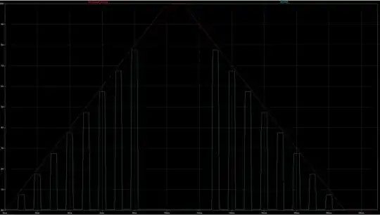

The output looks like this:
LTSpice power multiplexer output
One of the aspects that is different from the real-life bank of switches concept is that LTSpice doesn't like not having a load on a SW element. Hence the 10K resistors and the 1Meg resistor on the output. I would remove the latter when turning this into a component as I don't think it would be necessary for real application.

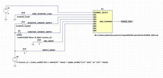

EDIT1: The intent was to turn this into a subcircuit that could be used anywhere, which is precisely what I did. Here it is in its application form:
You probably connected them diferently, but as long as both inputs of the VCSW are connected, there is no need for a load. At the worst, the error log will show a warning about a floating node (and warnings are not errors).

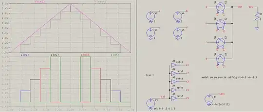

That said, here's another version of what (I think) you're trying to achieve. It's bidirectional, despite what the picture shows:
test

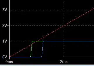

As it is, the voltage at the control pin, V(ctl), selects an input based on the equivalent of int(): if int(V(ctl))==1 then it connects the first input (maybe I should have labeled them 1, 2, 3, 4, instead of a, b, c, d) with out, if int(V(ctl))==2 then it connects b <-> out, etc (see V(test) for comparison, its only purpose in the schematic). Anything outside the range means all switches are off.
In your schematic, you're using the switches without vh specified. That defaults to 0, which means an abrupt switching around the transition. You should know that there are very good reasons not to choose that behaviour (read this, for example). Because of this I have added vh=-0.5 (also be sure to read the manual under LTspice > Circuit Elements > S. ..., especially the part right beneath the first table). To make use in full of this smooth switching, you should also add tau=<value> to the buffers. This way you can eliminate cross-conduction, except for an insignificant portion. For a more pronounced effect, set vt higher and vh=vt-1. Here's how it looks with tau=1m for the buffers and vt={x} vh={x-1} for a .step param x 0.5 0.9 0.1:
cc
There may be cases where an abrupt switching is needed, for example to see the behaviour of a resonant tank, but, in general, a non-negative vh will work in simple cases like this, but when involved in more comples ones, particularly in feedback systems, it can be a cause for "timestep too small" errors.
Your choice for Ron and Roff is a very good one: the values won't influence the output that much while keeping the dynamic range of 1e12 or less. In case you need heavier loads, you could tweak it to be (e.g.) Ron=10u Roff=10meg, but don't forget about the negative vh.
Not lastly, all this can be encapsulated in a subcircuit with an appropriate symbol, see this excellent answer on how to do it. The only needed parts are the buffers, A[1:n], and the switches, S[1:n] (and the .model card), while the nodes are a, b, c, ..., n, out, and ctl. You may add a 1g resistor to ground inside the circuit, for those cases where the ctl pin might be floating, somehow (the simulation might abort with an error). As I said, it's bidirectional, so out is not such a good choice for a label.
There is a reason why you got an error without a resistor. Referring to your last picture, you tried to feed V2 through S6 straight into S8's input, but VCSWs are pure voltage mode: their inputs don't consume current, and current monitoring is disabled for this reason -- just try to feed a voltage source straight into a pin of a VCSW and try to plot the current through the wire (not through the source). Therefore S6, without R2, has no effect, but with it, it can act as a controlled voltage divider.
Also because of the pure voltage mode, leaving any control input floating may result in a "singular matrix" error, since it is expected that the pin must have a potential, of any kind. It might work, it might not, but to be safe the only cure is to add something, anything, even a capacitor.

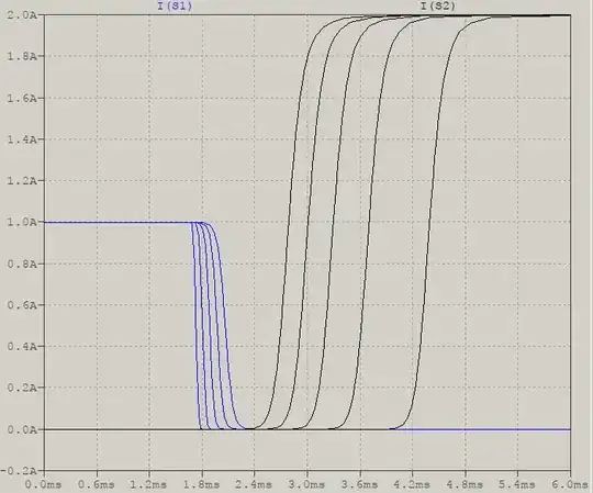

Regarding your comments and recent edits, if you need the switches to have a larger window, then you can add another batch of buffers to help. Plotted against int(V(ctl)) you can see that they turn on/off symmetrically around the transitions:
gapped
This can be added as a parameter, here thres, for better control. Of course, the values don't need to be 1±thres, 2±thres, etc, they can be any other: 3.14±thres, 1.618±thres, ... In fact, thres doesn't even need to be symmetrical around the value, you can always add thres1 and thres2. You can also make the thresholds overlap, you'll see nice cross-conduction. Here's the source for the .asc file:
Version 4
SHEET 1 1116 680
WIRE 576 -432 512 -432

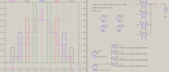

If you know the controlling voltage doesn't dally too long in the transition regions, half of the buffers can be eliminated. I'm not sure it can be simplified further (but I'd love to be proven wrong). The changes are in the addition of vhigh for the buffers, and a modification for vt and vh for the switches:

SYMATTR InstName A3
SYMBOL Digital\\buf1 208 288 R0
WINDOW 3 20 90 Left 2
WINDOW 0 42 46 Left 2
SYMATTR Value ref={4-thres} tau={tau} vhigh={4+thres}
SYMATTR InstName A4
TEXT -64 -344 Left 2 !.tran 0 1 0
TEXT -64 -424 Left 2 !.model sw sw ron=1m roff=1g vt=0 vh=-10m
TEXT -64 -384 Left 2 !.parma thres=0.25 tau=1m
a concerned citizen

  • The convergence link is interesting. Great pointer on specifying Vh to avoid issues. I like your circuit, it's simple. Didn't realize you could specify a threshold for buf1. I also like your use of sequential buf outputs to turn on the channel switches. That said, I used low and high threshold detectors (THn_L and THn_H) in my schematic in order to avoid cross conduction issues. I have fine control of the on/off window of each channel switch. For example, the first channel is designed to be on between 0.8 and 1.2 V. The second channel 1.8 and 2.2, etc. Probably not the best solution. – martin's May 03 '21 at 14:36
  • I am accepting your answer because of the idea to simplify the circuit and the very useful advice. As is always the case, there are myriad solutions for something like this. It will be interesting to see what others might come up with. – martin's May 03 '21 at 14:37
  • BTW, on the point about choosing switch on/off resistance. I ended-up having to increase the off resistance to 1gig. In actual application I saw that the circuit under test ended-up trying to drive all power sources a little bit and the simulator ground to a halt because of this (picoseconds/s). When I set roff to 1 gig the simulation got back to full speed. There might be some other fundamental issue with my model. I'll continue to fine tune and see how far I can get. – martin's May 03 '21 at 14:40
  • Sorry, one last comment with reference to the need for a load. What I was referring to was mainly that my two threshold detector switches (THn_L and THn_H) failed to turn on/off the channel switch (OUTPUT_SW) unless I added some resistance go GND. If I remove those resistors the circuit does not work. The mux output resistor is not an issue as that pin will never be disconnected from a source/load in practice. That said, I like your idea of adding a large value resistor to the model just to keep everyone happy. – martin's May 03 '21 at 14:44
