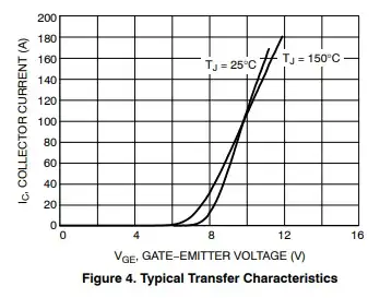

Janka asked an interesting question in comments, 'what about an IGBT?'. According to this app note, No detailed characterization of IGBTs as linear amplifiers has been carried out by IR, given the limited use of IGBTs in this type of application.
The VI graph from this data sheet for the NGTG50N60FW-D
shows the typical inflection at 9.5v \$V_{GE}\$ that characterises thermal instability, at 8v an increase in temperature from 25C to 150C results in a tripling of collector current, which sounds fairly unstable.

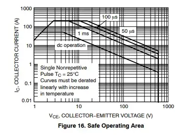

However, the SOA graph
does have a DC line, and that line is at just over 200Watts, the headline power of the device. Have they characterised it properly?
An IGBT requires no current to drive it, but does need more gate volts than a Darlington needs base volts, so may or may not be easier to drive. At the moment, I've not found any definitive information on IGBTs in this mode of operation.

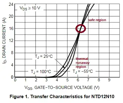

Unfortunately modern power MOSFETs fail when operated in the linear region at high power dissipations.
MOSFETs are safe to use in the linear mode as long as the drain current decreases with increasing temperature.
Most MOSFETs have a crossover below which they can experience thermal runaway and above which they don't. For very "good", low Rds(on) low Vth MOSFETs this crossover happens at a very high gate-source voltage and drain current. If you look at the "worst" MOSFETs some have the charge carrier dominated region at such low power it doesn't matter. E.g. IRFR9110 is safe at all Id > 1A
It has a Rds(on) of 1.2 ohms, but if you're going to be using it in linear mode that doesn't matter at all!
The other way to stay safe is to keep the power low enough. Power MOSFETs are made of many parallel cells, which in the (safe) mobility dominated region share current equally, but in the (unsafe) charge carrier dominated region don't, because hotter cells take more of the current and so get hotter. Fortunately the cells are very well thermally coupled, being on the same die, so if operated at a low enough power the die temperature will be nonuniform but will not exceed the limits.

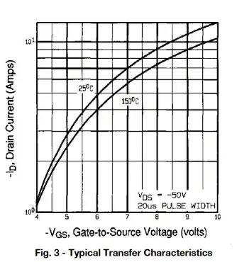

MOSFETs can be fine in linear mode, but extra care needs to be taken because the MOSFET will not necessarily distribute the current flow though it in a even fashion. Here is an application note from OnSemi (fairchild) explaining some of this behavior - and trying to sell newer devices.
This problem will manifest as a failure in an apparent safe operating area, especially in a traditional logic level trench FET. Older planar power FETs (IRF / Infineon does this) and a few of the newer types work well in linear mode. Planar power FETs tend to have atrocious on-resistance vs. die size though.

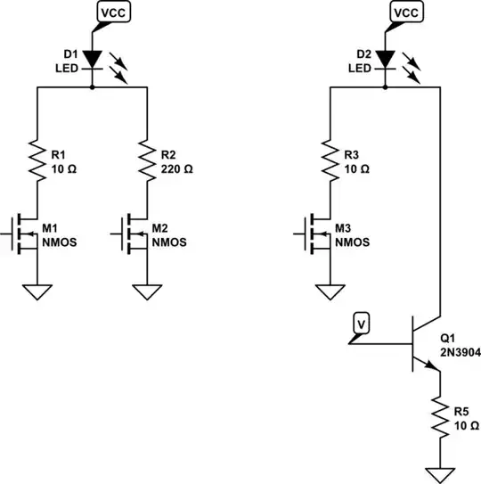

A better solution to your problem...
schematic
On the left: you can PWM one FET or the other. The different drain resistors determine current at the maximum PWM setting. When the PWM for the left FET reaches zero, you can continue decreasing the PWM of the other FET. This gives you much finer control in the low light intensities.
It's basically like a 2-bit power DAC with bit weights that you can adjust by choosing resistor values (and you should adjust resistors depending on what you need).
On the right this is the same, but a BJT wired as current sink provides analog control at low intensity.
I'd recommend going with the one on the left since it's the simplest and you probably have all the parts already.
Another good solution is to use a switching constant current LED driver with adjustable average current. This is the highest efficiency solution for high power LEDs. However if you drive a LED strip, this won't help much with efficiency, as the resistors in the LED strip will still burn power.

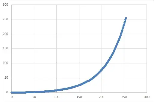

With 8-bit PWM, the LED jumps in brightness from zero to "reading a book" levels
You can control the brightness with a logarithmic scale. I've used the below formula for similar effect.
$$pwm = 2^{x/((0.69*255)/\ln(255))} -1 $$
It outputs 8 bit PWM values based on an 8 bit brightness input. The 0.69 is there to make sure it ends at 255.
You might want to create a lookup table, since this isn't a microcontroller friendly computation.
8 bit log

    You underestimate the sensitivity of the human eye. The problem with that approach is that PWM level 0 is fine (off), and PWM level 1 is more than a hundred times too bright. There is no level between 0 and 1. (Lower frequency PWM has its own problems, and does not appear to be an acceptable solution.) – piojo Feb 22 '18 at 07:48
  • In other words, the formula is not the problem. The lack of available PWM values is the problem. – piojo Feb 22 '18 at 08:01
  • @piojo The problem remains with 16 bit. It appears nothing significant is changing, until the last few thousand steps. – Jeroen3 Feb 22 '18 at 08:23
  • To grok the change, you need to view a graph with logarithmic y-axis. And in theory, 16-bit PWM is sufficient, but in practice it's not, due to visible blinking and what I think is a limit in the off-speed of the MOSFET. – piojo Feb 22 '18 at 08:25
  • I mean, empirically I know that 1/200 of the 1/255 lowest-level output is a workable graduation, because I have made a workaround involving a separate light source. But doing things the "clean" way, changing timers, I did not achieve a good result. – piojo Feb 22 '18 at 08:31
