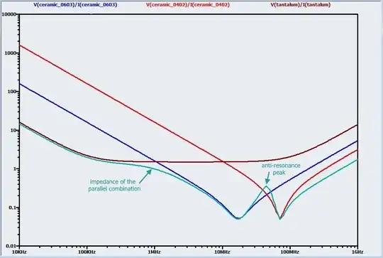

Figure 1: Impedance over frequency of three different value capacitors in parallel (cyan) vs their individual contribution (brown, blue, red). Image taken from https://www.allaboutcircuits.com/technical-articles/clean-power-for-every-ic-part-2-choosing-and-using-your-bypass-capacitors/
Figure 1: Impedance over frequency of three different value capacitors in parallel (cyan) vs their individual contribution (brown, blue, red). Image taken from All About Circuits.
Note the small anti-resonance peak. It seams no major trouble , and the overall behavior of the three different capacitors in parallel is vastly superior to their individual decoupling capabilities.

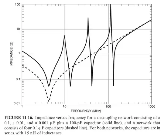

However, I have read in Electromagnetic Compatibility Engineering by [Henry W. Ott] that placing capacitors of different values may cause a much greater antiresonance-peak which can be very harmful for our designs (see Figure 2). In fact, it amplifies any noise that falls into the anti-resoance frequency range, which is corroborated by this paper.
Figure 2: from Electromagnetic Compatibility Engineering, by Henry W. Ott, section 11.4.4
Figure 2: from Electromagnetic Compatibility Engineering, by Henry W. Ott, section 11.4.4. The 15nH inductance makes reference to the capacitors ESL.

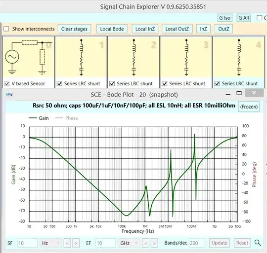

Summary: the individual capacitors need dampening; for 100uF caps, the solder and PCB foil may suffice (10milliOhm, if L = 10nH); for 1uF, use 0.1 ohm; for 10nF, use 1 ohm, etc.

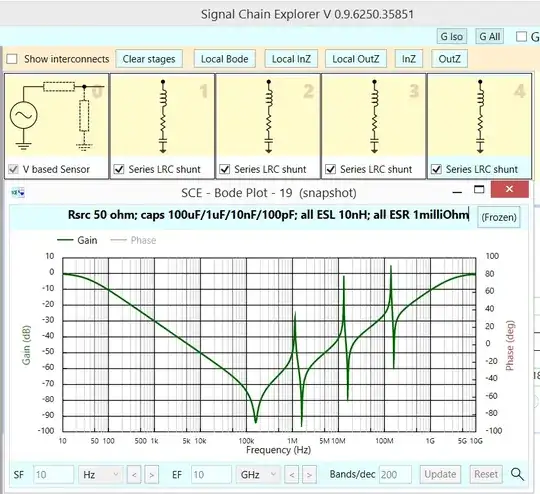

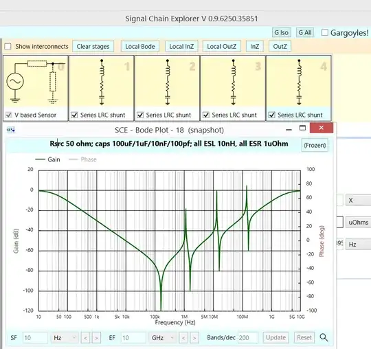

Here with 4 capacitors, 100U/1U/10n/100p and 10nH ESL, the peaking depends on the losses in each cap {I consider sqrt(L/C) a good start; thus 10nH and 10pF needs 3.1 ohms, which I have not used here; however, 10nH and 100uF need 10 milliohm, which is illustrated in the 3rd screenshot.}
Lets examine this response, with 1 microOhm ESR in each cap. Notice the lowest dip is to -120dB. Zsource is only 50 Ohms. enter image description here
Now this response, with 1 milliohm ESR in each cap. Zsource is 50 Ohms.

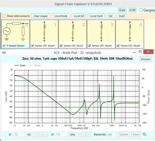

And now 10 milliohm ESR for each cap, Zsource is 50 Ohms.
And with 10milliOhm in each cap, with the Zsource now 1uH + 50 ohms

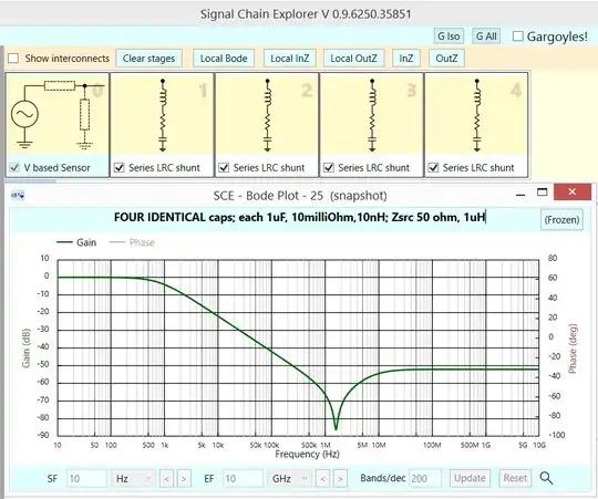

Here is (requested) SCE sim [available at robustcircuitdesign.com for free] with 4 identical 1UF caps, each with 10nH ESL and 10milliOhms. There are NO PEAKS, because the 10milliOhm dampens those peaks. [or is the Zsource, of 50 ohms and 1uH, what dampens??]

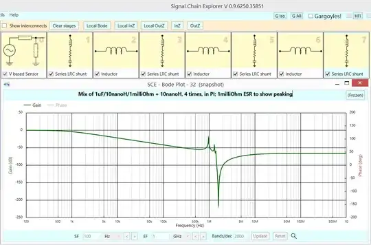

In prior sim, there was no peaking. So I insert 3 inductors between the 4 caps. Now a sim of those 4 caps + 3 inductors (PCB foil, 10nH each). Notice the peaking returns (the ESR is only 1 ONE milliohm, to show peaking), at -20dB.

    Thank you very much! Your simulations clearly show that, as stated by Ott, we can expect very high anti-resonance peaks at certain frequencies (here 1.05MHz, 10.5MHz, and 105MHz). Could you also simulate what happens when the capacitors are the same value to compare? With say 10mOhm ESR. I have no access to Signal Chain Explorer (sadly). – andresgongora Jul 26 '17 at 07:55

  • Thank you for the reference. I've been playing with the software a bit myself. So, judging the experiments, unless I know exactly where my noise falls I'd rather want to use same-size capacitors, right? But because bulk capacitors have high ESL and ESR, they can be added into the mix without problems. Please correct me if I got this wrong. – andresgongora Jul 28 '17 at 11:23
