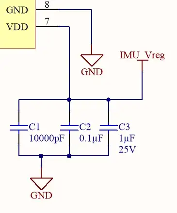

A PCB I'm working with has three decoupling capacitors on an IC's Vdd pin - 0.01uF, 0.1uF, and 1uF. They are all in 0402 packages.
I understand that capacitors of multiple sizes are often used because parasitics tend to scale with size, but I was under the impression that this was generally because of different package sizes, not the actual capacitance values themselves.
I also understand that putting multiple capacitors in parallel will increase the overall capacitance while decreasing parasitic values, but I don't see why one would use varying capacitances for that rather than just using the largest value possible for each capacitor.
Is there any reason to use multiple decoupling capacitors with the same package but different capacitance values?
Here's a screenshot of the relevant portion of the circuit schematic (C1, C2, and C3 are all 0402 MLCCs):
Schematic portion w/ decoupling caps

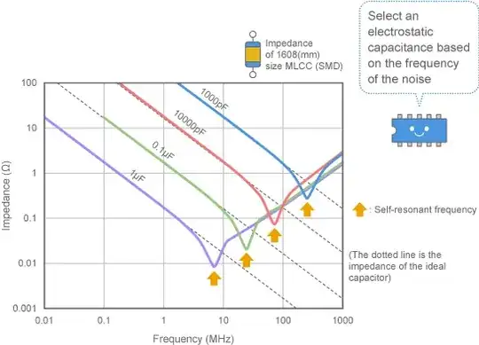

Your initial impression is incorrect. Here is what the impedance of various capacitors in the same package looks like.
impedance
Source
In order to get a sufficiency flat power supply impedance over a wide bandwidth, one needs to use a selection of different capacitors.

    I don't see at all how you can reach that conclusion from your illustration. On the contrary - you can see that the 1 µF capacitor dominates the whole range, and using two in parallel is far superior below 20 MHz, and roughly the same above. The impedance for "smaller" capacitors are only lower in a tiny fraction of the frequency range. – pipe Jun 26 '19 at 16:17
    @pipe keep in mind that this is a log scale. At the 100nF resonant frequency the 1uF capacitor has about 2-3 times higher impedance. You use something like 1 1uF, 5 100nF, 25 10nF capacitors. You can achieve the same with 1 + 15 + 75 = 91 1uF capacitors. Look at power integrity (PI) resources for more information. – user110971 Jun 26 '19 at 18:42

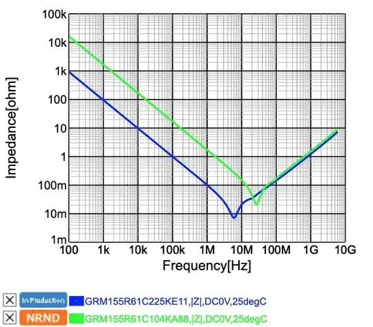

There may be some small benefit. Using a Murata's SimSurfing tool, I graphed the impedance vs. frequency curve for a 2.2uF 0402 (1005 metric) MLCC compared to an 0.1uF one in the same package. The 2.2uF cap is shown in blue in and the 0.1uF in green:
Impedance vs. Frequency for 0402 MLCCs: 2.2uF, 0.1uF
As you can see, the point of resonance is higher in frequency with the 0.1uF, as would be expected of a larger cap with the same parasitic inductance, but, less expectedly, the smaller MLCC achieves a slightly lower impedance between 10 and 40 MHz, at the expense of higher impedance at lower frequencies, as would be expected given the greater capacity of the 2.2uF cap.
So the conclusion is that there's something about the internal structure of the large-valued MLCCs that slightly worsens their high-frequency performance, but below the point of resonance, there seems to be no benefit to the smaller MLCC in a decoupling application.
Of course, the larger capacitor will also have worse performance under DC bias, but generally the larger ones will still end up having a larger effective capacitance under DC bias.
