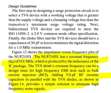

I was going through an application note by On Semi, System Level Surge Suppression Solutions for the CAN Bus -AND8253/D, where it says that the TVS diode's resonant frequency can be a design issue for high frequency EMI tests like BCI and that adding 5pF capacitors in parallel with the TVS diodes is the solution. I'm not sure I understand this very well, could someone please elaborate. My general doubt is that the resonant frequency of ESD diodes is usually not specified in the datasheets and also the impedance versus frequency curve is not available, so how do I determine the resonant frequency. ALso how is the resonant frequency a design issue for high frequency BCI , is it because at the resonant frequency the impedance is minimum ?
One other doubt is that in the screenshot that I have attached below, it says that the total capacitance of choke filter and TVS devices has to be less than or equal to 30pF for 1Mhz signal, but in the next paragraph it says that adding 5pF capacitors help in the design issue caused by resonant frequency of TVS diode for BCI, but wouldn't this 5pF add up to the existing capacitance of choke filter and capacitance of TVS diode and further increase the capacitance and maybe go above 30pF ?

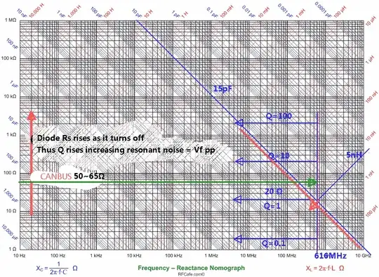

I cannot verify the performance of adding 5pF to this TVS diode. Layout will affect their results and outght to look like this. enter image description here
This is how I graphically compute Q of parallel and series resonant parts.

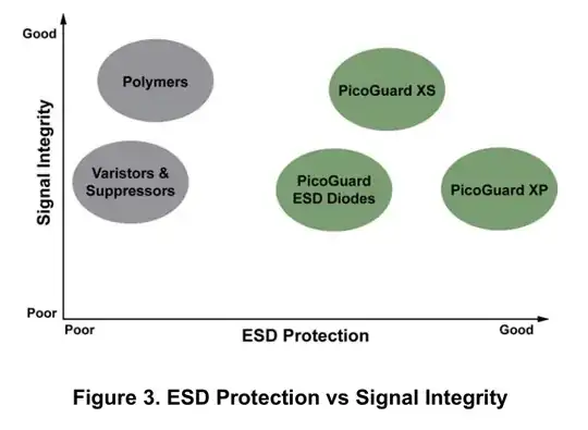

TVS diodes are good up to 10Mb/s and maybe higher for this part perhaps 100Mb/s BUT NO HIGHER.
For ESD transient protection on VHF,UHF data rate , it is preferred to use Voltage Variable Material (VVM) ESD suppressors have unique properties of 0.1pF and low ESR.
https://www.littelfuse.com/products/polymer-esd.../xtremeguard-esd-suppressors.aspx
www.sunlordinc.com/UploadFiles/2011/12/01100729ED707227.pdf
enter image description here https://www.onsemi.com/pub/Collateral/TND412-D.PDF

  • Cables are most often the biggest problems in a product EMC certification. Twisted pairs or ribbon cable with alternate grounds or even coax are never perfectly balanced so unintended radiation must be tested. If there is a signal on the data line that is clamped by the diodes to each rail then the cable "might" radiate that signal like an antenna. Suppressing the EMI internally is often done with ferrite beads , cap feedthru connectors or in this case the OEM suggests a small RF cap. If one has a sensitive Rx near this band this may be relevant. But it not for every design. So it depends. – Tony Stewart EE75 Apr 09 '19 at 18:25
  • So it depends. on the level of stray AC or SMPS noise that may cause the diodes to conduct and radiate back UHF noise. – Tony Stewart EE75 Apr 09 '19 at 18:29
  • @SunnyskyguyEE75 "If one has a sensitive Rx near this band this may be relevant. But it not for every design. So it depends" - Do you mean that if my data rate is not near the resonant frequency, it shoudn't really affect my application ? In my application, the CAN speed is 500kbps, so at max, the data rate would be 250kHz. – NIDHI Apr 09 '19 at 18:30
  • Your data rate has harmonics (and other things about your circuit) might cause noise at the resonant frequency which then gets amplified. – DKNguyen Apr 09 '19 at 18:41
  • @Toor could you please explain why the resonant frequency of the diode is a design issue for high frequency EMI/EMC tests? – NIDHI Apr 09 '19 at 18:44
  • Often the biggest issues are from a tower with an earth-grounded chassis and SMPS noise filter to gnd going to a target with a floating SMPS and the two interact with CM noise on data causing data errors while also radiating harmonics from SRF resonant ESD diodes intended to protect that are now becoming unintended radiators thru the USB cable. – Tony Stewart EE75 Apr 09 '19 at 18:45

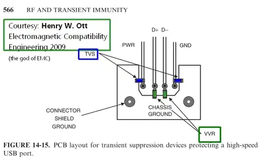

  • @NIDHI Did you notice I showed a VVR on the data lines D+ D- since they are much lower pF . Do you know how LC resonance works? – Tony Stewart EE75 Apr 09 '19 at 18:49
