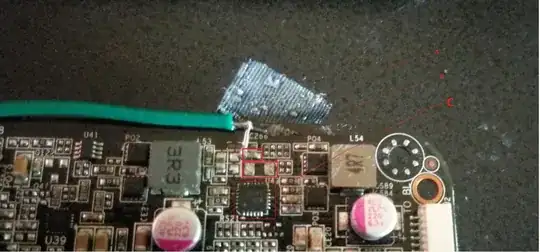

I am trying to repair a motherboard that had a shorted ceramic capacitor (1206 package) in position B. The voltage across the pads is ~19V. I put in a 10 μF 25V-rated ceramic cap, and the motherboard could be powered on, but the cap quickly became very hot (75°C after a couple of minutes), even when the board was just plugged in, and not powered up. The smaller ceramic cap in position A is in parallel with the cap in position B, and they seem to be decoupling the power supply for the IC in position C. enter image description here Fundamentally, my question is how to puzzle out the capacitance of the shorted cap (or, alternatively, an explanation of why the 10μF cap might be inadequate). But a secondary question is why the need for two ceramics (of different capacitance) in parallel.
One idea is to just get the datasheet for the IC, and see what decoupling cap values are specified. Unfortunately, googling the markings on the IC ("EN=FG 82W") don't lead to any obvious result. Perhaps someone here is knowledgeable enough to identify the chip by its appearance.
Needless to say, I don't have access to the schematic, and the manufacturer wasn't forthcoming with the needed info.

  • Yes, it's a laptop MB. And this seems to be part of the standby circuitry: the power button only has its 3.3V when this IC is powered. – tavr Dec 17 '19 at 01:10
  • have you measured the voltage across the cap? If it is stable, on 1206 package. X5R dielectric take the maximum value capacitor you can get. – user19579 Dec 17 '19 at 05:08
Assuming your brand new cap is still in good condition, without internal shorts... if it gets hot this is due to ripple current from the nearby DC-DC chip.

Have you considered whether one of the larger bulk capacitors has died? If so, it would result in large currents and voltage fluctuations in the smaller ones and thus heating.
The topology you have there is a switch mode dc-dc converter. It will be operating in the 100kHz to 2MHz region and likely converting a few amps. The caps will be taking quite a chunk of this current.
The chip is probably something like allegro ARG81801. If you read the section on that's datasheet about capacitor selection you'll see you need a fairly large X7R type, they're recommending 13.8uF minimum.
