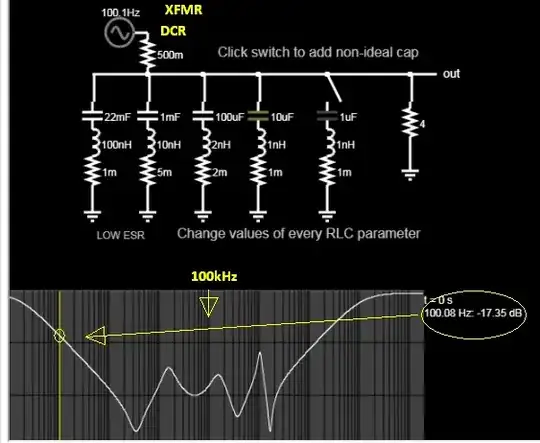

A Class D amplifier presents noise current in the audio band, as well as the switching frequency and all harmonics. The power source pulses large caps thru the rectifier only for the duration of the rise in ripple voltage of about 10%. So the source current has 10x the harmonics and also double the line frequency.
This is not ideal but something like the filter you can get with high Q ultra-low ESR caps enter image description here

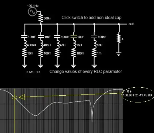

This is guessing a poorer select of bulk cap and slightly higher ESR enter image description here
Your question is irrelevant to class D Amp but very relevant to RF filters with ceramic series and parallel resonance effects from too low ESR.
