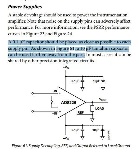

If you look at reference schematics, IC will almost always have a 0.1uF decoupling cap, sometimes a 1uF or 10uF caps on some chips, and a few bulk caps.
Example from an opamp datasheet:
The EEVBlog has a very nice video about decoupling caps.
