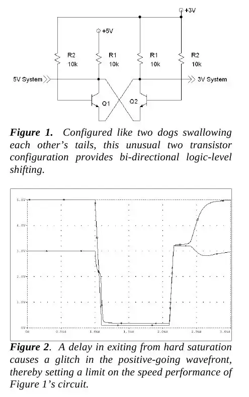

I am trying to make a logic level converter using transistor BC547. This is to convert Voltage level of Rpi Gpio from 3.3 to 5V. I have wired the circuit according to this diagram: enter image description here
I have done this to convert 3.3V to 5V for PWM application. I have connected the circuit to GPIO no 17 and set it high

    Please clarify #2. Other end of what with respect to what and what voltage is at the other other end.. whatever THAT is..... – Trevor_G Apr 05 '17 at 19:29
  • @Trevor it is a bidirectional converter so i have connected the gpio to 3v end of converter and i am expecting to get 5v on the 5v end of converter when gpio is set to high . voltage with respect to ground of rpi ..i am too confused on this one !! – Mr.Sky Apr 05 '17 at 19:31
  • Did you connect the 5V and 3.3V supplies to the points shown in the schematic? – Trevor_G Apr 05 '17 at 19:37
  • @Trevor Yes !! i did that ! – Mr.Sky Apr 05 '17 at 19:38

  • @Trevor It's overkill even for a two-way transfer. One could just get rid of the BJT with the 5 V and resistor at its base. It's not needed as the other BJT can operate in reverse active mode. – jonk Apr 06 '17 at 05:45
  • @jonk, transistor with 5V at the base? I don't see that, only a 5V pull-up. However, even then the 3-5v action makes a really ugly transition. – Trevor_G Apr 06 '17 at 14:23
    @Trevor Nah. It's not as bad as you imagine, I think. Try it out in spice and see what you think. About equally clean (and ugly) in either direction. – jonk Apr 06 '17 at 17:34
  • @jonk I was just going by the OPs graph. – Trevor_G Apr 06 '17 at 17:35
    @Trevor All I meant is that the second BJT doesn't add much that's useful. Now, there is a difference in the rising vs falling edge. But I'm almost sure that's not improved with the extra BJT. I'd have to double-check, though. – jonk Apr 06 '17 at 17:37
    @Trevor By the way, the way that schematic is laid out is terrible for trying to understand it. It's also a terrible, and completely useless description about "dogs swallowing tails." It's almost as though it was intentionally meant to mystify rather than to clarify. – jonk Apr 06 '17 at 18:04
  • @jonk I totally agree. I have run into that so many times over the years working on other peoples schematics. In many, many cases I have had to redraw the thing to figure out how it is supposed to work. – Trevor_G Apr 06 '17 at 18:09

I hate adding an answer here, especially since the OP doesn't even need bidirectional operation. But the circuit is laid out terribly (for understanding it.) And the description about dogs and tails does not help, excepting perhaps alchemists trying to write down allegorical and mystifying bits of their "art."

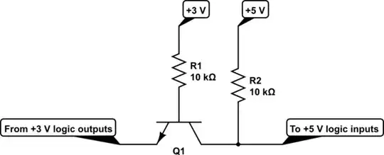

One way to use a BJT for level shifting is to use it in a common-base mode. Just wire the base to a rail and "pull down" on its emitter. You can place the resistor either at the base or at the emitter. All that's left to do is to use a pull-up on the collector. Given that we hope to achieve bidirectional use, the resistor will be placed at the base.
Here's an example when going from a \$3\:\textrm{V}\$ logic output towards a \$5\:\textrm{V}\$ logic input:

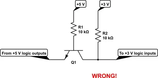

Going in the the other direction it is very tempting to use a symmetrical approach:
schematic
simulate this circuit
But that doesn't work. Why? Because the base has \$5\:\textrm{V}\$ available to it and the collector's pull-up is hooked towards a lower voltage, \$3\:\textrm{V}\$. This means that the base-collector diode (no longer commonly shown on the symbol, though it once was when BJTs were themselves made more symmetrically) can be (and will be) forward biased. So when the BJT is supposed to be turned off, it actually isn't. Instead, there's a forward biased diode caught between \$5\:\textrm{V}\$ and \$3\:\textrm{V}\$ with two resistors to limit the current. So the output will be at some middling value above \$3\:\textrm{V}\$ but also not quite \$5\:\textrm{V}\$.
The symmetry fails.

And the answer is, yes you can. In fact, what I did is simply reproduce that dog-eating-tail circuit that the OP presented. It's the same thing. But now you can see the progression that led to it. And it's not as confusing as some odd, cross-wired dog-tail thing anymore. It's just two individually worked out circuits put together into one larger one.

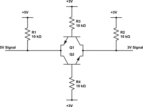

This is an emitter coupled convertor and as such needs no ground connection.
NOTE schematic labelling is a little ambiguous. "3V System" and "5v System" are the logic signals. +5V and +3V are the logic supply rails.
When you pull either side low you pull down the emitter of the opposite transistor which turns it on pulling the opposite output low.
The internal pull-ups handle the high logic states.
By the way, ground point is IMPLIED on that schematic. It is whatever +3V and +5V are referenced to.

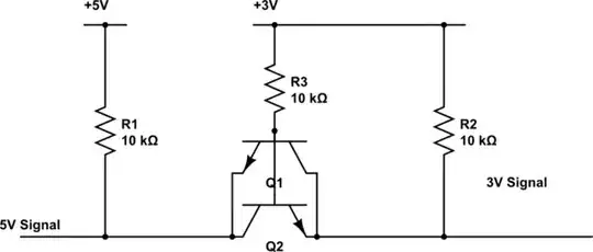

Inspired by Jonk's answer I redrew the schematic this way to make it a little "clearer".
schematic
But, in reality R3 and R4 can be combined, and the two transistors become a bi-direction transistor.
schematic
Which pretty much gets you to the same place as Jonk's answer.
