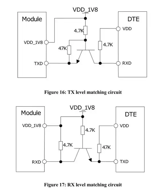

How does this circuit work?
Where VDD = 5 V (MCU) and VDD_1V8 = 1.8 V.
It is a recommended circuit to use UART communication when the voltage level are not the same, I think.

In either direction:
  • With TXD high, the emitter is pulled to or above the base supply voltage and the transistor turns off. This allows the collector/RXD junction to be pulled high by a resistor.
  • With TXD low, the emitter is pulled below the base supply voltage. Current flows into the base, the transistor turns on, and the collector is pulled down to around 0.2V.

  • Thanks a lot I understand now, you are a great person!. I think I can add to my pcb the circuit without doubts – asterix May 13 '19 at 15:25
