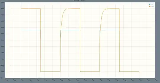

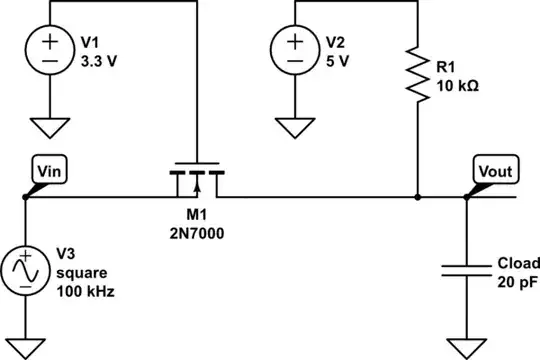

This is a simple level shifter where speed is not important and current gain is not required. It requires only one resistor and a single TO-92 or SOT-23 (eg. 2N7002) transistor:
schematic
As you can see, the rise time is a bit slow, and there is very little drive capability because of R1, and sink current is limited by the GPIO, but it will work into a CMOS input or similar.
For more stringent requirements, I recommend a voltage translator chip. You can do a parametric search at a distributor and find many kinds that can translate from one voltage to or from another.

  • Pretty much what you'd expect to get with $\tau=200:\text{ns}$. – jonk Sep 15 '20 at 02:55
  • @jonk Yes, the MOSFET is not without drain capacitance. – Spehro Pefhany Sep 15 '20 at 02:56
  • With $5:\mu\text{s}$ half-cycle and figure about $5\tau$ to get to the top there, I get $1:\mu\text{s}$, or 20%. Which is about where your curve comes out. So the drain capacitance must not affect the simulation too much. – jonk Sep 15 '20 at 03:00
    Crap. Just tried the 2N7002 in LTspice. The curve is much worse than you show. (I guess that drain effect is now pronounced.) 99% is reached in about $4:\mu\text{s}$. LTspice doesn't have much confidence in those, I guess. I just tried out the ones I suggested to the OP, the BC547 and also the 2N5551 and they appear to work lots better than the 2N7002. (I used a 10k on the base.) Of course, that's still just simulation again. – jonk Sep 15 '20 at 03:06
    @jonk I see similar or better results in LTspice with the Philips model and much worse with the Fairchild and the mystery one in the /misc directory. – Spehro Pefhany Sep 15 '20 at 03:20
  • Would you chock that up to variations in the same device name made by different manufacturers as well as devices within manufacturers for NFETs? I don't use them nearly as much as I do BJTs, so I have much much less idea about how they may vary, one to another. Or is it just bad model development in some cases? (I know I have some of these laying about, so I guess I could just build and see. But I know I only have them from one manufacturer. So I really can't check across manufacturers without buying some more.) – jonk Sep 15 '20 at 03:28
  • @jonk Good question. Coss Philips typ. 6.8 max 30. Fairchild typ. 11 max 25. (pF, measured under the same conditions). – Spehro Pefhany Sep 15 '20 at 03:34
  • Well, the max isn't that different, anyway. And it's probably the figure I'd be using for design. So that more than doubles the tau. – jonk Sep 15 '20 at 03:43
  • @jonk Given >4:1 difference maybe one model uses typical and one uses max. – Spehro Pefhany Sep 15 '20 at 03:44
  • I see Cgdmax=80p Cgdmin=12p Cgs=50p Cjo=50p for the LTspice model I have. – jonk Sep 15 '20 at 03:46
  • The philips model I have is a .SUBCKT (from ORCAD.) It behaves almost as badly as the Fairchild. But slightly better. I'm coming to the conclusion that if I were doing this, I'd just add the extra 10k and go with the BC547, perhaps. These NFETs are bugging me too much, seeing this much variation, and I know better how BJTs work and could tinker where needed. You chose a very good frequency to highlight this -- entirely by accident. But there it is. – jonk Sep 15 '20 at 03:51
