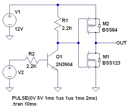

When I search for level shifting 5V pulse to 12V, I came to know about the circuit given below. enter image description here
It is simply based on a push-pull amplifier configuration as you all know. And what I have understood is, when the input reaches 5V (high) level, then Q1 conducts and since it is an NPN transistor, it will make the gate of the MOSFETs both low so that Q3 starts to conduct and vice versa for when an input is 0V. When we see a graph in an oscilloscope it will show 12V pulse as in the attached graph given below.

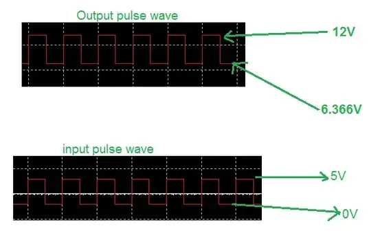

But when input pulse goes low (0V), I cannot see an output voltage at 0V. Instead, I am getting 6.366V in output wave instead of 0V. why does that happen and how to resolve this problem?

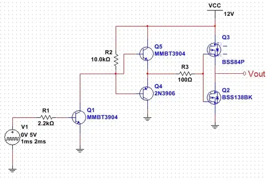

Edit: As per suggestions from the comment, I have attached an output node.

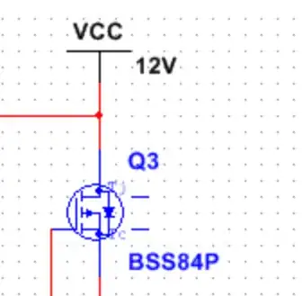

  • Notice the body diode drawn in the Q3 symbol. With that diode in mind, how much current would have to go through the Q2 drain to drive the output low? – The Photon Apr 05 '18 at 04:16

  • @ThePhoton, Yes. Q3 was like that when I did a simulation and the output node is shown now. – CNA Apr 05 '18 at 04:35

  • Actually you see that 6.366v because BSS138K is not in its ohmic region, which looks weird since BSS138K Vgs(th) =~1.0v. So try replacing it by a 2n7000 and flip BSS84P vertically and it´ll probably work. – Iron Maiden Apr 05 '18 at 05:01
