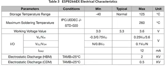

Let's look at an ESP8266 datasheet:
Here, you can see that the current compliance for an I/O pin has a maximum value of \$I_{MAX}=12\:\textrm{mA}\$. This means you should plan to stay well under that value. I like to stay below half of the maximum, with still less being better if I can manage it. Less is better because if you are using several different I/O pins like this at the same time, the loading adds up and there are dissipation limits for the entire port and for the entire device, too. Even if they aren't stated, they exist. So keep things as low as possible.
Also take note of the voltage limits. Assuming you are operating on \$V_{CC}=3.3\:\textrm{V}\$, then they guarantee a high output voltage of 80% of that, or $$V_{OH}\ge 2.64\:\textrm{V}\label{voh}\tag{Voh Min}$$ (This means, when sourcing \$I_{MAX}\$.) They also guarantee a low output voltage of 80% of that, or $$V_{OL}\le 330\:\textrm{mV}\label{vol}\tag{Vol Max}$$ (This means, when sinking \$I_{MAX}\$.)

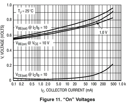

In this case, I'd use what I have a lot of: OnSemi PN2222A devices. Let's start by examining Figure 11:
Look at Figure 11 and you can get a lot of important information. The first is that they "recommend" operating it as a switch with \$\beta=\frac{I_C}{I_B}=10\$. (You can see this in two places: the lowest curve on the chart which is the value of \$V_{CE}\$ when saturated, where they specify \$\frac{I_C}{I_B}=10\$ and also the top-most curve which they identify in the same way.) So this means $$I_B=4\:\textrm{mA}\label{ib}\tag{Ib}$$ which is well within the limitations of your I/O pin. So that's nice. The second is that $$V_{BE}\approx 800\:\textrm{mV}\label{vbe}\tag{Vbe}$$ with that collector current. (Just look along the x-axis to find the collector current, then look up to where the curve intersects a y-axis value.) This last detail will be used in the design.

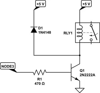

Time to prepare a schematic:
schematic
The value of \$R_1\$ is pretty simple to compute. First, assume that the I/O pin is operating at its lowest output voltage when high. You already know this value from above, \$\ref{voh}\$. Also, you know the typical value for the base-emitter voltage of the BJT from above, \$\ref{vbe}\$. And finally, you also know the likely base current, \$\ref{ib}\$. So just compute: $$R_1=\frac{2.64\:\textrm{V}-800\:\textrm{mV}}{4\:\textrm{mA}}=460\:\Omega\label{r1}\tag{R1}$$
The nearest value would be \$470\:\Omega\$. So that is what you see in the schematic. The diode, of course, provides a path for the relay's magnetic field energy to collapse, when you try to turn it off. It otherwise doesn't conduct.
Say your I/O pin is more powerful than we assumed and holds a full \$3.3\:\textrm{V}\$ when driving high. Then the I/O pin and BJT base current will be \$\frac{3.3\:\textrm{V}-800\:\textrm{mV}}{470\:\Omega}\approx 4.4\:\textrm{mA}\$. This is also just fine and won't hurt anything at all. So this design should work well.
There are reasons for adding a resistor to ground, from the BJT base. One is that it helps keep the base near ground if for some reason the other end of \$R_1\$ were floating and not connected to your ESP8266. And there are other reasons. But it's not vital here, so I'll leave out the discussion of it for now.
EDIT: With you indicating (in comments below) value of \$100\:\textrm{mA}\$ for the relay, which is 2.5 times as much as I'd used above, you could consider the idea of using 2.5 times the base current. But also most of these small signal BJTs can work well as a switch with higher values of \$\beta\$ than I earlier suggested from reading Figure 11. Let's look at Figure 4, now:

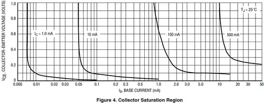

Here, you can see a curve labeled \$150\:\textrm{mA}\$, which is more than you need. The x-axis is the base current \$I_B\$, and the y-axis is \$V_{CE}\$. You want a low value for \$V_{CE}\$ and you can see that it plateaus out at around \$100\:\textrm{mV}\$. Keeping in mind that these are typical curves and not guaranteed curves, you can see that using \$I_B\approx 8\:\textrm{mA}\$ looks pretty solid (far away from the curve knee) and that \$10\:\textrm{mA}\$ is even better. Well, this suggests that \$\beta\$ from about 15 to 20 is probably going to work pretty well.
Taking all this together for your relay at \$100\:\textrm{mA}\$, you need about 2.5 times as much base current because of the increased relay load but you can afford to drop it by a factor of from 1.5 to 2.0 because of the Figure 4 curve. So perhaps going from the earlier computed \$I_B=4\:\textrm{mA}\$ to perhaps \$I_B=5\:\textrm{mA}\$ to \$I_B=6.7\:\textrm{mA}\$ is just fine.
Let's re-compute the earlier equation for \$\ref{r1}\$: $$R_1=\frac{2.64\:\textrm{V}-800\:\textrm{mV}}{5\:\textrm{mA}}=368\:\Omega\label{r1x}\tag{R1 redo 1}$$
$$R_1=\frac{2.64\:\textrm{V}-800\:\textrm{mV}}{6.7\:\textrm{mA}}=275\:\Omega\label{r1y}\tag{R1 redo 2}$$
Between these two? I'd just go with \$R_1=330\:\Omega\$. I think that would be sound. Worst case I/O pin current should be approximately \$7.5\:\textrm{mA}\$. This is well below the maximum of \$12\:\textrm{mA}\$ for the ESP8266 datasheet table I show above, but enough under it that I wouldn't be too concerned. (At least, not unless I knew I was repeating this driver across a large number of I/O pins. In that case, I'd probably go look to see if there was a specified limit for the port or device as a whole.)

  • Excellent answer! This will be the circuit I use, I already have some 2N2222A that I've scavenged. I thought I had this material down pat, but I'm glad you went into the detail that you did because I see that I'm a little shaky on some things: First, I'll be paying attention to the guaranteed values for high level output voltage and factor in the 80% (or whatever is the case), instead of just using the full 100% in my calculations. The thing that really surprised me was your use of the beta parameter of collector current / base current. I've been using hFE all this time. I glossed over –  Aug 20 '17 at 01:55
  • the calculations in my question, so: I measured 100mA through the relay using a 5V supply (I can't get the datasheet because I've glued over the printing). I multiplied this by a suggested 2X- 5X safety margin, so I settled on 260mA. Isn't that what I use for collector current? I divided this by the hFE of 100 to get a base current of 2.6mA. So here's where I'm all confused: thought hFE was the current gain of the base to the collector. Rearranging beta = Icollector / Ibase gives base current X beta = collector current. Where have I slipped? I'm also puzzled by the graph in Fig. 11, –  Aug 20 '17 at 02:58
  • @Ray71 You have to over-drive the BJT if you want it acting like a switch. Look at Figure 11. You can see curves with $V_{CE}=10:\textrm{V}$ and this would be with a $\beta$ you are used to. But the other curve is for "saturation." Which is what you want with a switch. If your relay current is $100:\textrm{mA}$ then I think you will be fine using a $\beta=15$ or a little higher, perhaps. Which makes it still work for your I/O pin. – jonk Aug 20 '17 at 03:08
  • At the top there are 3 plots, 2 of which are well labelled, but the third one simply says, "1.0 V". Even though I used the one labelled, "Vbe(sat) @ Ic/Ib = 10" I'm curious about the "1.0V'. For the protection diode, I been in the habit of using ones in the range 1N4001-1N4007. How much does this matter. Again, out of ignorance, I thought that being "beffier" than the delicate looking 1N4148 meant it was more "heavy duty". I'm on board with the 1N4148 from now on, just wondering about the difference in behavior. I've inferred from he schematic that the diode's cathode should connect to the –  Aug 20 '17 at 03:14
  • @Ray71 The BJT becomes increasingly saturated as $V_{CE}$ gets less than a volt. You want to drive $V_{CE}$ well below a volt. So you must approach this as a saturated situation and you don't get to use the curves where $V_{CE}=1:\textrm{V}$ or $V_{CE}=10:\textrm{V}$, obviously. Those would be very bad switches. Feel free to use any diode that works for you. Most will survive. I didn't want to get into the details of calculating the inductive kick back. (It can be done.) – jonk Aug 20 '17 at 03:22
  • supply rail. I usually solder both leads directly across the terminals on the relay. I really have no idea whether this is important or trivial. So I'll use an improved version of the schematic I posted: S8050 replaced in favor of the 2N2222A, get rid of R1 altogether, and use a different value for my R2 to compensate for the different current load of my relay. 40mA to 100mA is a 2.5 fold increase. Increasing the base current by this amount gives Ib = 10mA. This is getting too close to the GPIO limit of 12mA for me, so I'm thinking like 8-9mA which means 220 ohms. I'll keep using R3. –  Aug 20 '17 at 03:38
