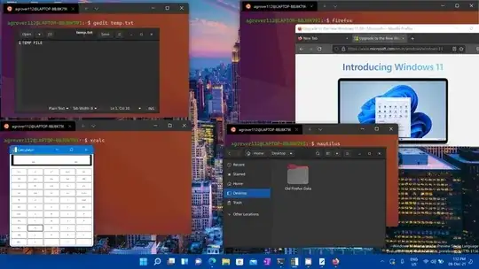

WSLg is now available on both Windows 10 and Windows 11, making it the preferred mechanism for most users. See below for updated installation/update instructions.
(Much) more detail:
So the question asks for three "scoring" criteria for techniques for running Linux GUI apps in WSL:
  • Ease of Installation
  • Ease of Use
  • Memory Consumption
I'm going to add to that:
  • Flexibility
  • Performance
"Easiest" is a matter of opinion, to some degree, but I'm happy to provide mine. In general, I think it's more important to understand all the available options and decide which one works for your needs.
At this point in time, there are at least three techniques for running Linux GUI apps under WSL:
  • WSLg
  • Install a third-party X server in Windows
  • Install xrdp and a desktop manager in Ubuntu/WSL and connect via the Windows Remote Desktop Connection
I'll cover each below.
WSLg
While not an option when this question was originally asked, Linux GUI apps are now supported out-of-the-box on WSL2 using WSLg.
And when my answer was originally written, WSLg was only an option on Windows 11, making it unavailable to a large number of Windows 10 users who couldn't upgrade for various reasons. This has now changed with the release of the WSL application package, making installation much easier for most all users.
Windows 10 users currently require KB5020030 or later, meaning your Windows build number will end in .2311 or higher.
Windows 11 and Windows 10 xxxxx.2311 users should then be able to install or update with:
wsl --install
# or, if already installed
wsl --update
# to confirm:
wsl --version
GPU acceleration is also supported in WSLg using updated drivers. Pulse Audio is also preconfigured.
The WSLg architecture utilizes a read-only "system distribution" based on the CBL-Mariner distribution that Microsoft also uses for its Azure Cloud Services. This distribution is preconfigured to run Wayland/XWayland, with the sockets shared via the internal WSL network and symlinked to the appropriate files (e.g. /tmp/.X11-unix) for each WSL2 distribution you install (e.g. Ubuntu).
The DISPLAY and WAYLAND_DISPLAY variables are preconfigured by the WSL /init (PID 1) process on initial startup.
Note that WSLg only works for WSL2, not WSL1 instances.
WSLg Summary and Scoring:
  • Ease of install: Now that Windows 10 users can also install, this is almost certainly the easiest of the three techniques for most use-cases.
  • Ease of use: Excellent
  • Flexibility: Most flexible in some ways -- Runs Wayland/Weston/Xwayland. Can run a Weston-on-Weston implementation to run a full screen desktop if desired.
  • Memory Consumption: Short answer -- Around 213MB to run xterm. We can assume the majority of that is from the WSLg infrastructure. Regardless, I also tested the other two scenarios below with xterm, so it's memory usage is the rough constant in these measurements.
    See footnote at end of this post for more information on the memory usage of WSLg. Note that this includes Wayland, Xwayland, and Pulse Audio support with this memory footprint. The other two options listed below do not include Wayland or Pulse Audio.
  • Performance: Highest once it is loaded - GPU accelerated. glmark2 of 666 on my system (nVidia 2070 Super), which sounds low, but remember that this is being composited onto the Windows desktop. It's almost double that of VcXsrv and around 4 times that of xrdp.
    However, note that there is an initial delay while the system distribution is copied and started the first time you launch any GUI application in a WSL2 session. On my, high-midrange performance system, this delay is about 5 seconds. Additional GUI application launches after that are sub-second.

According to the official documentation:
You can now preview Windows Subsystem for Linux (WSL) support for running Linux GUI applications (X11 and Wayland) on Windows in a fully integrated desktop experience.
WSL 2 enables Linux GUI applications to feel native and natural to use on Windows.
  • Launch Linux apps from the Windows Start menu
  • Pin Linux apps to the Windows task bar
  • Use alt-tab to switch between Linux and Windows apps
  • Cut + Paste across Windows and Linux apps
You can now integrate both Windows and Linux applications into your workflow for a seamless desktop experience.
Prerequisites
Installing GUI applications on WSL.
Assuming, you've satisfied all the prerequisites and have already installed WSL, you've to now update WSL.
  1. Open a PowerShell window, by clicking Start → typing "Power Shell" → right-clicking Windows PowerShell → Run as administrator.
  2. Update WSL:
    wsl --update
  3. You will need to restart WSL for the update to take effect:
    wsl --shutdown
You're now ready to begin using GUI apps on WSL.
NOTE: Support for GUI apps on WSL does not provide a full desktop experience. It relies on Windows desktop, so installing desktop-focused tools or apps may not be supported.
Install any GUI application, for example, for installing gedit, run:
sudo apt update
sudo apt install gedit
For launching gedit, run:
gedit /path/to/any/file/you/want/to/edit
