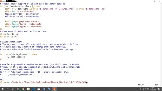

After that, I have write following alias in bashrc file via vim and save it:
alias adt='sudo /usr/local/bin/mgl-tools/mgltools_i86Linux2_1.5.6/adt'

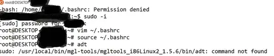

When I call the tool this error is generated.
sudo: /usr/local/bin/mgl-tools/mgltools_i86Linux2_1.5.6/adt: command not found

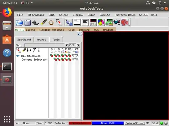

I just tested it in Ubuntu 18.04 VirtualBox:
wget http://mgltools.scripps.edu/downloads/downloads/tars/releases/REL1.5.6/mgltools_x86_64Linux2_1.5.6.tar.gz
tar xvzf mgltools_x86_64Linux2_1.5.6.tar.gz
cd mgltools_x86_64Linux2_1.5.6/
sudo ./install.sh -d /opt/mgl/
sudo cp initMGLtools.sh /opt/mgl/
Then add to /etc/bash.bashrc
export PATH=/opt/mgl/bin:$PATH
source /opt/mgl/initMGLtools.sh
But can you may test it directly:
/opt/mgl/bin/adt or adt
