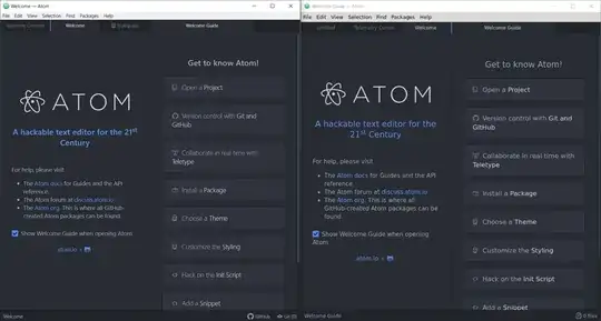

Here's a screenshot of the problem. The window to the left is run through Windows and the right one is run through Ubuntu:
screenshot of the problem, the window to the left is run through Windows and the right one is run through Ubuntu

As commented by @CarlosRafaelRamirez the solution to the problem is explained here (assuming you are using VcXsrv)
