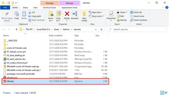

Open the Ubuntu Directory: Copy the command from below these instructions Paste the command into PowerShell Press "Enter"
cd c:\users\admin\.ubuntu
Create the Shortcut: Copy the command from below these instructions Paste the command into PowerShell Press "Enter"
powershell.exe -file .\04_create_shortcut.ps1
Open the Directory in Explorer: Copy the command from below these instructions Paste the command into PowerShell Press "Enter"
explorer .
Launch the Ubuntu Desktop: Double-click the "Ubuntu" shortcut
