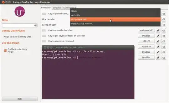

15
How to restore Dodge behavior in 12.04
This Ubuntu Geek post and this newer WepUpd8 post report how to restore the Dodge Windows and Dodge Active Windows for Unity in 12.04. These can then be set in the Unity plugin in CompizConfig Settings Manager. Update: For 12.10 / 13.04, please refer also to this WepUpd8 post.
It is required to add a ppa:
sudo apt-add-repository ppa:ikarosdev/unity-revamped
and run a distribution upgrade:
sudo apt-get update
sudo apt-get dist-upgrade
Then open CCSM and set it to your favorite behavior!
Dodge Window and Dodge Active Window behavior restored in Ubuntu 12.04. The terminal is only to document Ubuntu version. (The terminal is only to document Ubuntu version.)
You might have to log out and in again for it to take effect.
This patch also restores the old Click-To-Minimize behavior. See this Webupd8 post for details.
