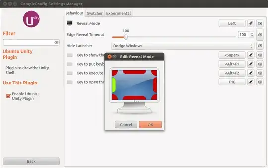

To adjust the reveal mode of the Launcher, you can use compizconfig-settings-manager Install compizconfig-settings-manager. To install CCSM, run the following command from the terminal:
sudo apt-get install compizconfig-settings-manager
In CCSM, look for Ubuntu Unity Plugin and click on the option for Reveal mode. Using the Reveal mode, you can choose which part of the screen should trigger the launcher.
You might want to configure the launcher to never hide such that you can use the launcher properly.
