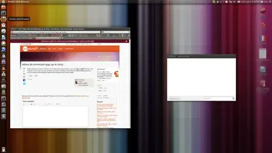

Some apps appear as a separate icon in the launcher on the left. Some icons (usually those pinned to the launcher) can just be clicked on. In this example, I have the main browser window and the downloads window minimized. When I click the Firefox icon in the launcher, I see all the Firefox windows like this:
firefox windows
