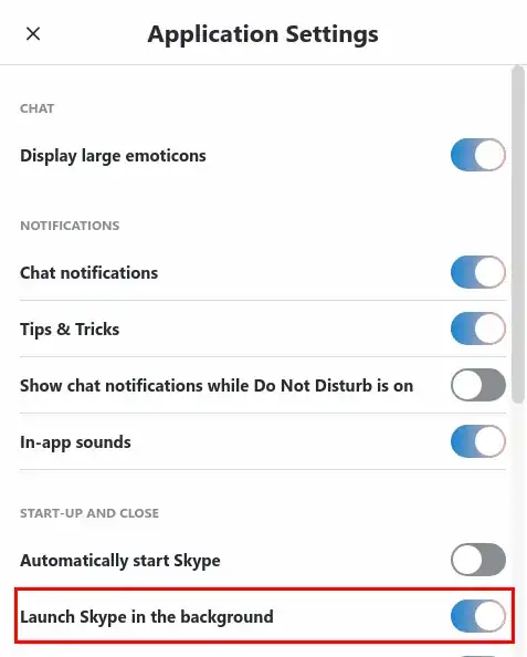

"Launch skype in the background" is not an option now so I'm trying to bypass it. I tried to add this line to the autostart file:

This seems to be an XY problem. Newer versions of Skype does support starting in the background. Go to Tools > Settings and toggle on "Launch Skype in the background".

I updated to 17.10 and switched from Unity to Gnome. It fixed the problem.
