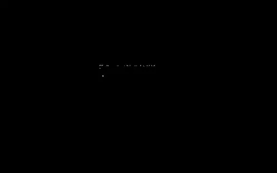

By the way, it says FATAL: Could not read from the boot medium! System halted.
The vdi must be reattached to the VM after VBoxManage command. Further, the partition will need to be resized from WITHIN windows, because you will have this empty space:

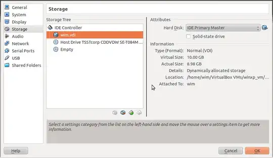

Since VirtualBox 6 we can use a GUI for resizing VMs' virtual disks.
To access it, click File -> Virtual Media Manager ...
Version 7: in Tools -> Media
The following window will open VirtualBox Virtual Media Manager
Select your disk, and click Properties. Now just move the slider at the bottom or write the value you want for the size and click "Apply" when you’re done.

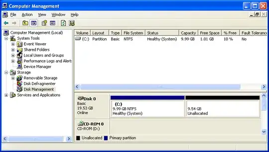

After you start the virtual machine, Windows will not recognize the new space.
In Windows, open Computer Management (search for it in the start menu), select Storage -> Disk Management in the left menu (In Windows 10 you can find it as create and format hard disk partitions directly from the start menu). Select your partition (probably C:), right-click on it, and select Extend Volume .... Now just click through the wizard and you're done.

However, I understand how mileage can vary :-) As far as resizing the partition, in Windows 7, I was able to resize at the screen you showed by right clicking on the C: drive in the bottom panel and selecting extend volume.
Computer management screen

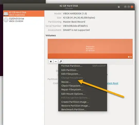

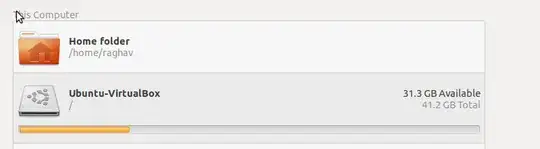

Go to "Disks"
Resize the existing partition to make it 40 GB:
You can then confirm from the "Storage" that the above operation worked:
