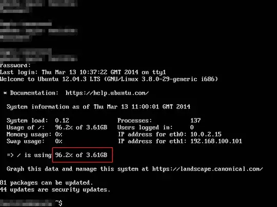

But when I boot I first see that this hasn't helped:

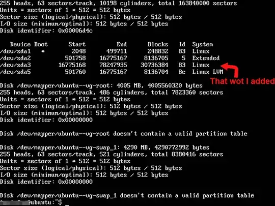

And here is the output from fdisk -l:
I am stuck at this part - how do I now tell my machine that it can use the new space so I don't get disk space errors?

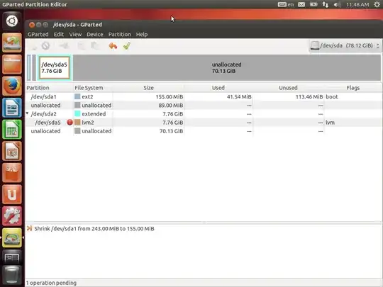

I deleted the 30gb partition I made and tried to just resize but I am unable to use Gparted to resize the partition because Gparted says lvm2 is not supported(?):

You made the wrong decision. You have to resize the partition instead of creating a new partition.
  1. Now boot from Gparted and delete the newly created 30Gb partition
  2. Resize the old partition and get the space you need
    To resize it, click ‘Resize/Move’ button
  3. Next, use the slider to drag the line to the left to repartition the free space. The available free space is the area with the white background. Ubuntu is installed in the area with the yellow background. When you’re done, click ‘Resize/Move’ button to apply the changes.
  4. Finally, review the changes and click ‘Apply’ to save.
