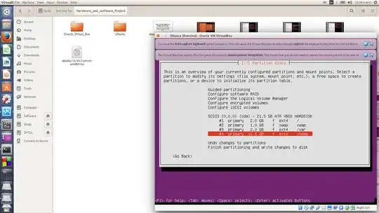

How can I solve this problem: I have four drive in VirtualBox like below but I want to increase my first partition.
my partition screenshot

Note: I've oracle virtualBox guest with 4 GB hard-disk
How can I increase the disk size of the virtualBox guest?

Note that you have 2GB for the /, 1GB for swap, other 2GB for /var and 16GB for /home. Basically you have assigned 2GB for all the operating system, installed programs and, apparently, the /build directory you are using to compile the dspace project.
You may check the free space in each partition using df -h. It is possible that the root has 100% used while you have some free space at /home.
I think you want to resize the / partition. However, it may be not the solution.
  • Resize the partition: You can resize a partition only if you have free space adjacent to the partition. It is possible that / be adjacent to the swap. Then, you may try to boot a LiveCD and use gparted or another tool to remove the swap partition and resize the /. However, you will get only 1GB and you will need a new swap partition.
  • Expand the hard disk, resize the partition and create a new swap partition: You can resize the hard disk, delete the swap, resize the / and create a new swap partition in the remaining space. However, you will get only 1GB more for the root.
