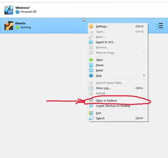

In the host System you need to give full permission to the VM files. In windows you can do this by right clicking on the VM files -> Click on Properties option (last option in menu) -> Click on Security -> Edit -> Select Users -> Check-mark on Full Control -> Press OK and close the box.
Now try again the resizing the Partition in the Guest OS.
For example for Ubuntu VM -> Ubuntu.vmi, Ubuntu.vbox You can find the above files by right clicking on Guest OS in virtual box then click on the Show in Explorer option as following picture. enter image description here
