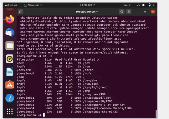

Then when I ran the following command I got an error:
$ sudo apt-get upgrade
ERROR: You don't have enough free space in /var/cache/apt/archives/
The output of df -H command is:
This is my terminal screen
Please help, I want to install pip on my virtual machine (ubuntu)

You can clean the apt cache using:
 sudo apt-get clean
