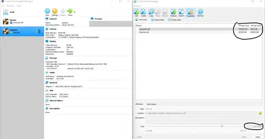

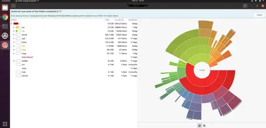

This is my disk usage
The 100GB I allocated to the OS

  • The disk usage analyser shows the root partition at just under 10GB and virtually full.
  • The VB media manager shows the entire disk to be about 100GB and about 9GB used.

Just as your second photo shows, the Virtual Size 100GB is the size of your VM oobuntu's space, that you can set it via VirtualBox on your Host Windows 11 machine. the Actual Size 8.94GB is the size of your VM oobuntu's disk space, that you only need to set on your VM oobuntu via APP liking GParted or partition tools at terminal.
