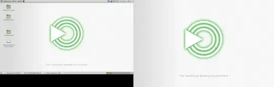

I tried converting Ubuntu to Ubuntu mate using
sudo apt-get install mate-desktop
and I supposedly removed the Gnome desktop but my screen appears blank. Even in the screen shots it appears but in reality it isn't.
