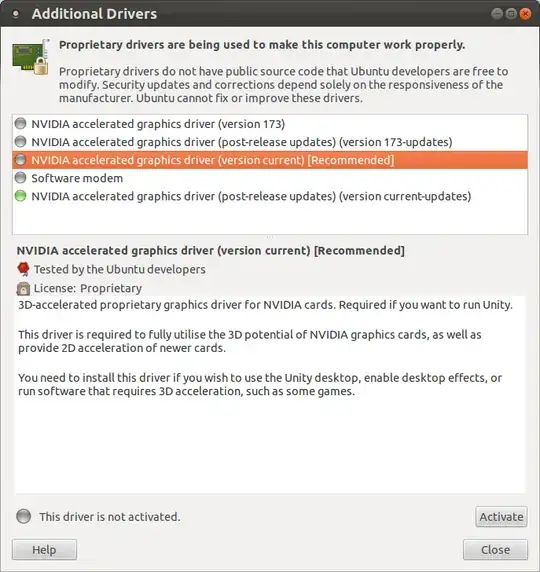

The Additional drivers application provides slightly more detailed descriptions of the packages.
Additional Drivers Screenshot
