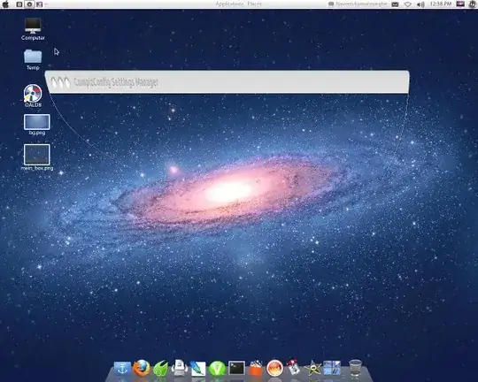

On Ubuntu 12.04, the Compiz visual effects appears to be glitchy. I see a "window flash", after rotating the "Desktop Cube". I've used the "Magic Lamp effect" when minimizing windows, but the window content, minimizes faster, delaying the window border to minimize. "So the border and the window content gets apart, like in the picture below". I've tried updating Compiz, but no luck. Magic lamp minimizing issue
How to fix this problem? Will Compiz work properly in XFCE? This didn't happen in Lucid Lynx. I appriciate any help!

For Lamp effect
I've tested Lamp (actually magic lamp) effect on Unity, Ubuntu 12.04. The effects is working nicely. I think, You should upgrade your unity and compiz related packages. This should fix problems.
