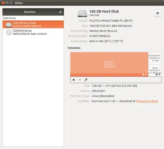

Go to the Dash and search for "Disks". You should see one application with that exact name. Open it to get the info you need.
Screenshot of Disks application showing the disks installed in the system
