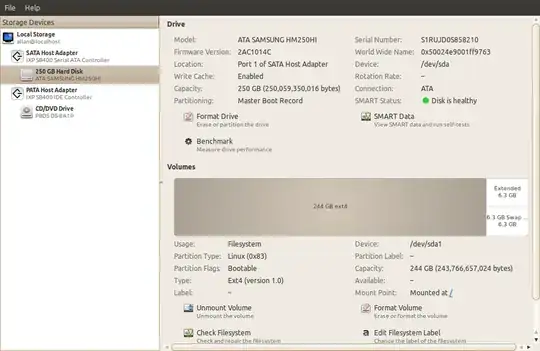

Disk Utility
This is a GUI application that will give you information about the model, size, serial number and device path of your drives. It is installed by default on Ubuntu Desktop. You can press the Ubuntu Dash button and search "disk utility" to find it, or run it in the terminal with palimpsest.
Disk Utility

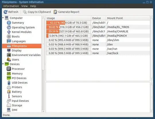

Hardinfo is a GUI which will allow you to gather your system Information, which may include, but not limited to, the physically connected Storage Devices and the File Systems, as shown in the next screenshots:
Hardinfo website: http://hardinfo.berlios.de/HomePage

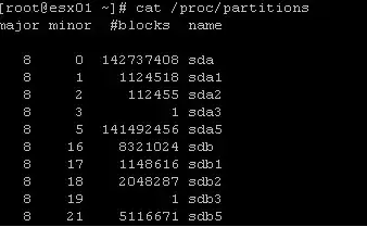

  • cat /proc/partitions show detected partitions/disk by the kernel, you can figure out by the size

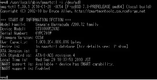

  • smartctl -i /dev/sda

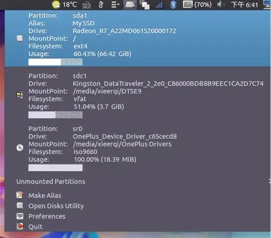

GUI approaches:
